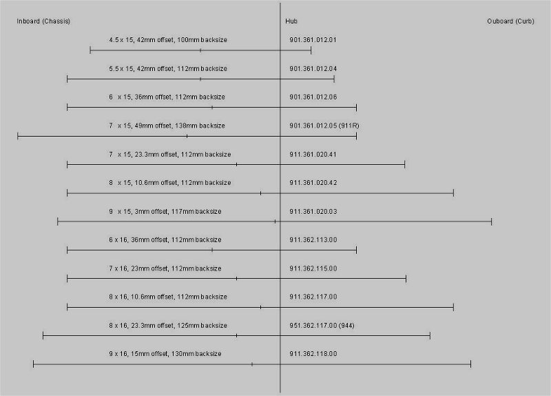

Porsche Rescue
post Dec 6 2005, 06:21 PM
Saving and Enjoying Old Porsches
Posts: 2,978
Joined: 31-December 02
From: Bend, Oregon
Member No.: 64
This might help, if it is readable.........
