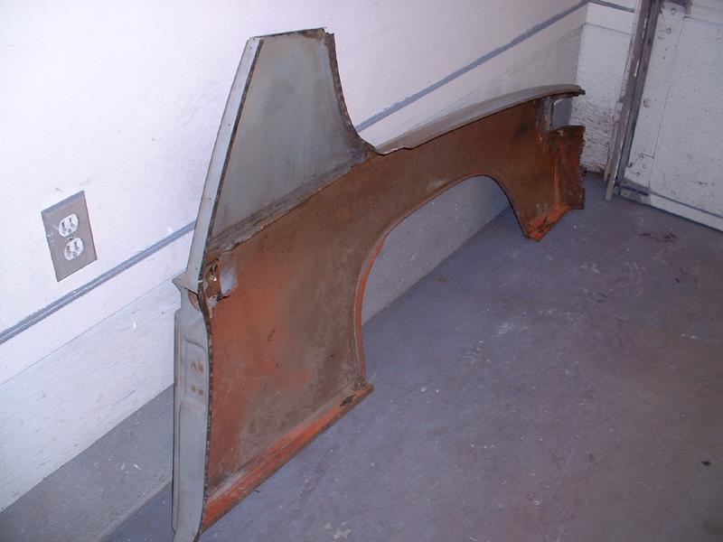

I didn't do this. Ask Eric Shea about it. He didn't do it himself but was close by.

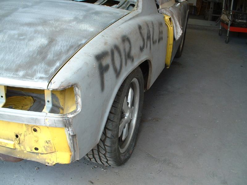

more before

after

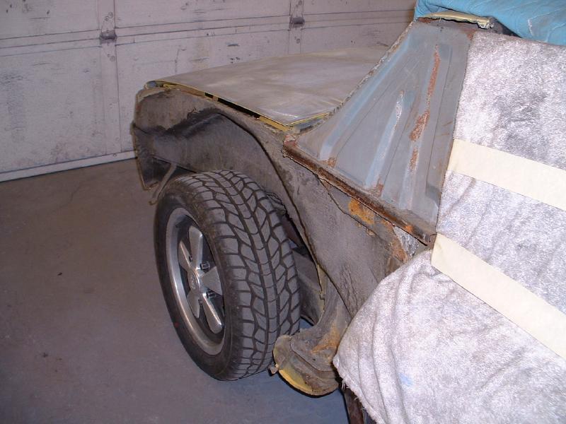

after after

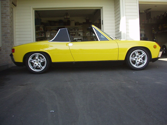

Jim, thats the wrong fender it has the narrow lip . start over (IMG:http://www.914world.com/bbs2/html/emoticons/laugh.gif)

Damn, Jeff, I thought you knew almost everything about these cars. Now I think you know EVERYTHING! Just went to the garage. Sure enough, the right side lip is at least a quarter inch narrower than the left! Guess you can put wider tires on a later car! When did the change occur?
Now I gotta do it all over again. Better pay attention to this thread so I can learn how. Or maybe I should just take the grinder to the left side! Gotta be "correct".
