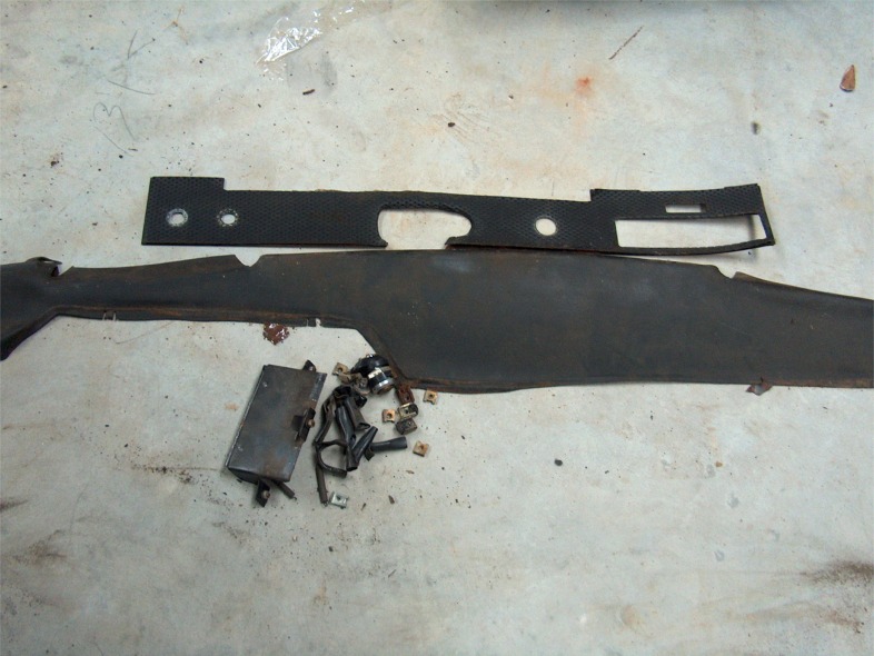

grasshopper
post Dec 18 2005, 07:28 PM
Post #46
Posts: 2,613
Joined: 10-December 04
From: Valdosta, GA
Member No.: 3,258
the stripped dash frame
