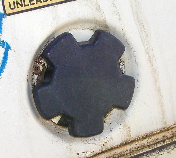

I looked at alot of cars at the dismantler but the round gas cap holes are usually 5" diameter to allow you to stick your hand in. The smaller ones like on the early Rabbit have a flange to mount the gas filler.
