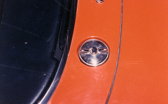

iamchappy   This is how mine looks with the door open.   Dec 16 2005, 04:05 PM
iamchappy   I topped off the stock cap with a wheel centercap.   Dec 16 2005, 04:06 PM
neo914-6   Nice touch, how about a clear door? ...   Dec 16 2005, 05:29 PM
