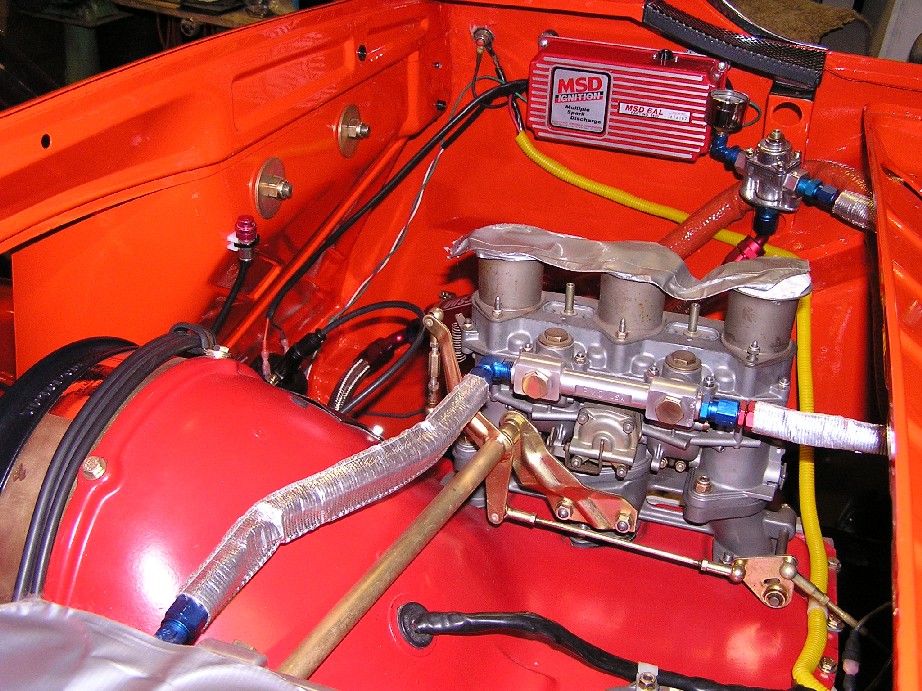

(IMG:http://www.914world.com/bbs2/uploads/blog-1111623740.jpg)
fuel lines come up the right side... hit the regulator, then a tee. one line to right carb, other line to left carb. fuel line runs across back bulkhead.... AA EDIT: CB linkage. Facet pump up front. tank - filter - pump - tunnel hardlines - rubber line to engine bay - filter 2 - cheapo regulator - tee - line to each carb |

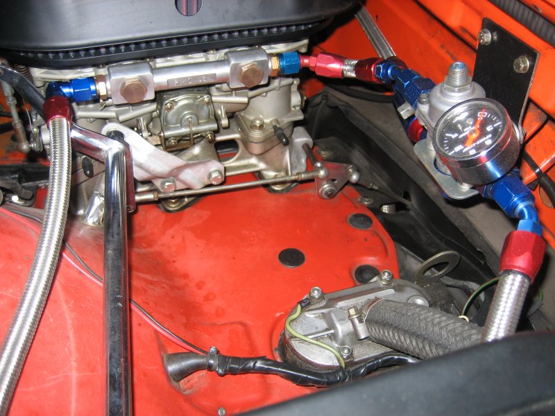

This picture is the new car (old car was the carbed -4)
this one has the regulator first, instead of back pressure.... but same thing. filter-pump 2 fuel lines. in one carb and out to the other and then back to the front tank! Attached thumbnail(s) ![]() |

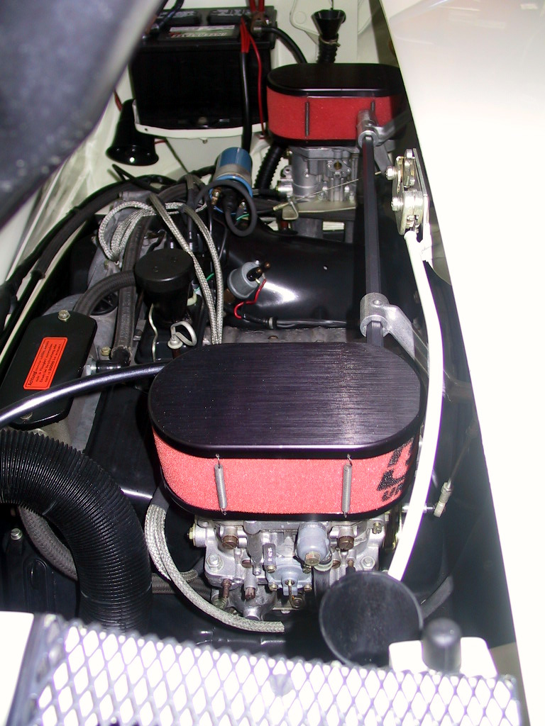

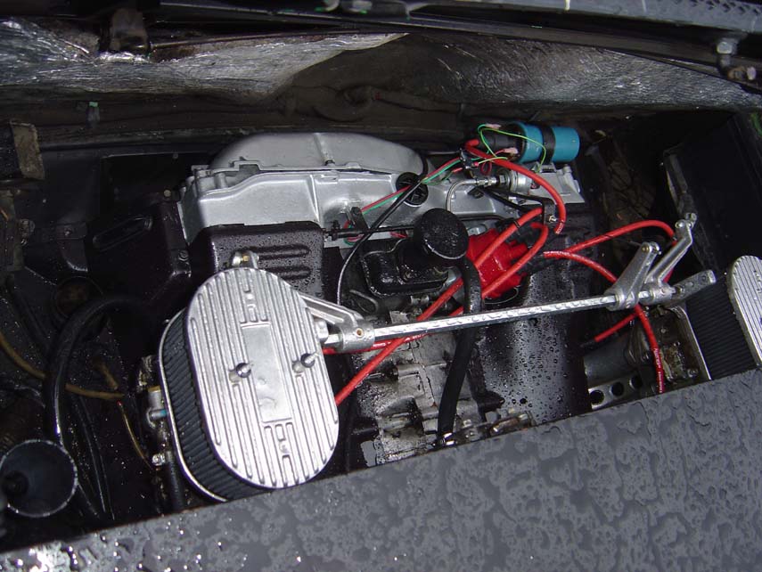

here is some pics from a thread like this that i startyed when i was a carb newb... (IMG:http://www.914world.com/bbs2/uploads/post-2-1072748822.jpg) (IMG:http://www.914world.com/bbs2/uploads/post-2-1072753870.jpg) lots of info URL=http://www.914world.com/bbs2/index.php?act=ST&f=2&t=7762&st=0&hl=]Here............[/URL] |

The second photo in Aaron's post with the red carb filters is my car. I used a six cylinder fuel pump with the factory return line and routed the fuel hose to the first carb which had a tee fitting, then along the rear of the bulhead to the other carb. I made a mistake of running one of those dial pressure regulators between the fuel pump and the first carb...the factory fuel pump is internally regulated and the aftermarket regulator set at 3-4PSI starved the left hand carb. Always check fuel pressure with a gauge.

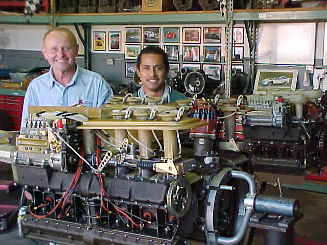

I built the lightest 914 in the history of mankind. ![]() ![]() ![]() ![]() ![]() ![]() ![]() ![]() ![]() ![]() ![]() ![]() ![]() ![]() ![]() ![]() ![]() ![]() ![]() ![]() ![]() ![]() ![]() ![]() ![]() ![]() ![]() ![]() ![]() ![]() ![]() ![]() ![]() ![]() ![]() ![]() ![]() ![]() ![]() ![]() ![]() ![]() ![]() ![]() ![]() ![]() ![]() ![]() ![]() ![]() ![]() ![]() ![]() ![]() ![]() ![]() ![]() ![]() ![]() ![]() ![]() ![]() ![]() ![]() ![]() ![]() ![]() ![]() ![]() ![]() ![]() ![]() ![]() ![]() ![]() ![]() ![]() ![]() ![]() ![]() ![]() ![]() ![]() ![]() ![]() ![]() ![]() ![]() ![]() ![]() ![]() ![]() ![]() ![]() ![]() ![]() ![]() ![]() ![]() ![]() Group: Members Posts: 127,402 Joined: 3-February 03 From: Jacksonville, FL Member No.: 222 Region Association: None ![]() |

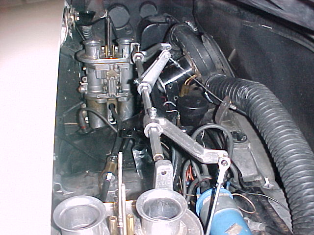

Here is a shot of the engine that I'm going to put in my car. You can see the linkage there in the middle of the shot. I drilled it out to save some weight. I don't know if this will help you or not.
BTW, these are the two guys that helped me steal it. Paul (IMG:http://www.914world.com/bbs2/html/emoticons/smile.gif) Attached image(s) ![]() |

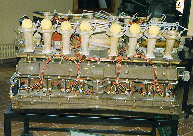

Professional Lawn Dart ![]() ![]() ![]() ![]() ![]() ![]() ![]() ![]() ![]() ![]() ![]() ![]() ![]() ![]() ![]() Group: Retired Admin Posts: 24,542 Joined: 1-February 03 From: Corona, CA Member No.: 219 Region Association: Southern California ![]() |

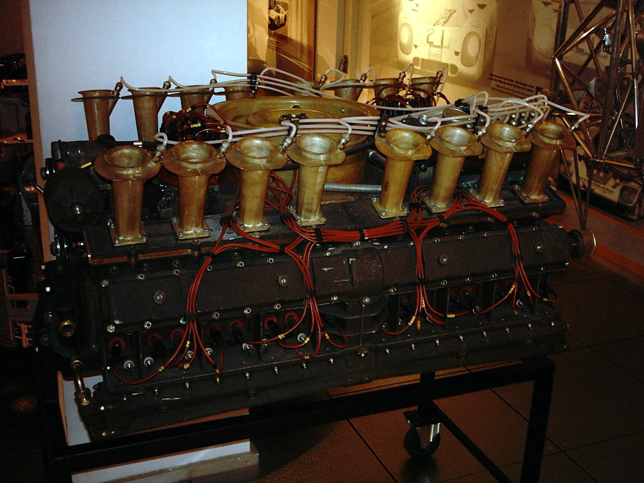

my flat 16 is being shoe-horned as we speek. suck my extra 4 cylinders paul (IMG:http://www.914world.com/bbs2/html/emoticons/flipa.gif) Attached thumbnail(s) ![]() |

#19
Here is a picture of my -16. MUCH better....
