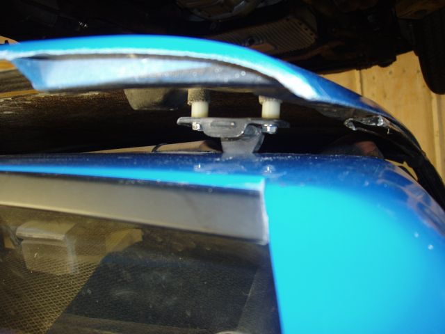

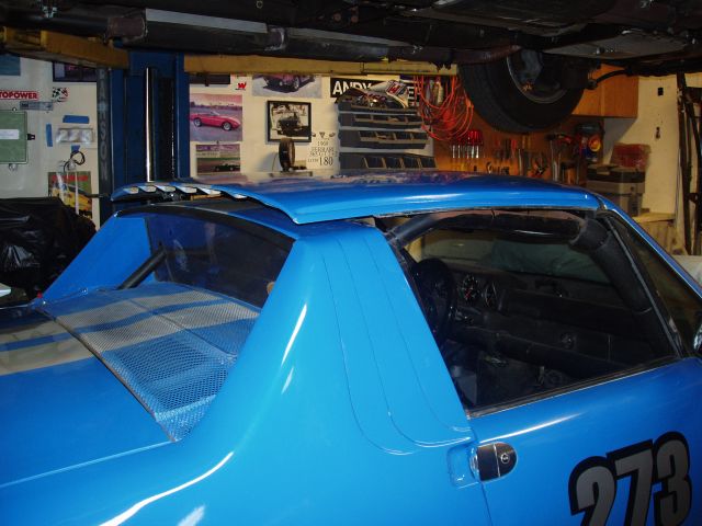

I had idle hands this weekend so I decided to modify my targa top. I put together what Brent did and what John did. I probably took it a little too far but only a track day will tell.
I added 1" of spacers to the stock latch and used a grinder to get rid of the reinforcement and rear seal area. I now have over 2" of clear space between the targa and the top. I'm a little afraid with that much air passing through that I might start creating lift under the top. If it seems like that is the case I can always remove the spacers and drop it down so I have about !" of clear space.
The first pic shows a side view. Looks kind of weird.

Like I said, pic 1

This one shows the spacers added to the stock latch.

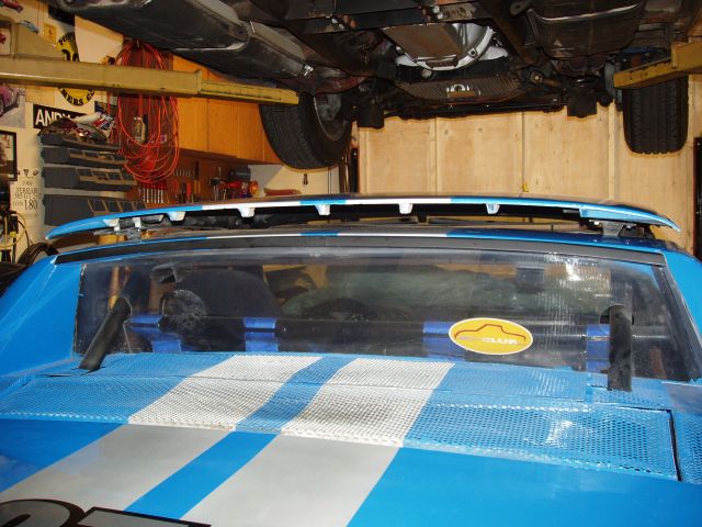

Here's one from the rear.

Great Job! Spacers are a great idea, since as you mentioned, you can tune the height of the gap.
I'm anxious to hear how your test day goes.
