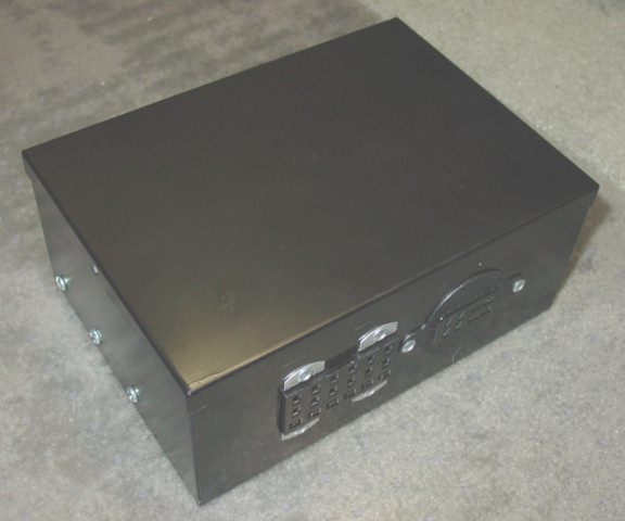

I rearranged the LT1 wiring harness to terminate at a plug with all the connections I need for the engine. This plug plugs into the 18 pin socket on the side of the box. Below that is an 8 pin socket for the trans (starter, reverse lights, trans cooler pump).

bondo   On the other side is a power connector where the m...   Jan 12 2006, 03:44 PM
bondo   The inside has 6 relays, for switching everything ...   Jan 12 2006, 03:46 PM
Mueller   looks good...what kind of connectors are those? d...   Jan 12 2006, 03:46 PM
bondo   They're old school "Cinch Jones" connectors. W...   Jan 12 2006, 03:48 PM
TonyAKAVW   Very nicely done.... Except for the wire nuts. <...   Jan 12 2006, 03:54 PM
bondo   Those aren't wire nuts! Those are crimps f...   Jan 12 2006, 03:59 PM
