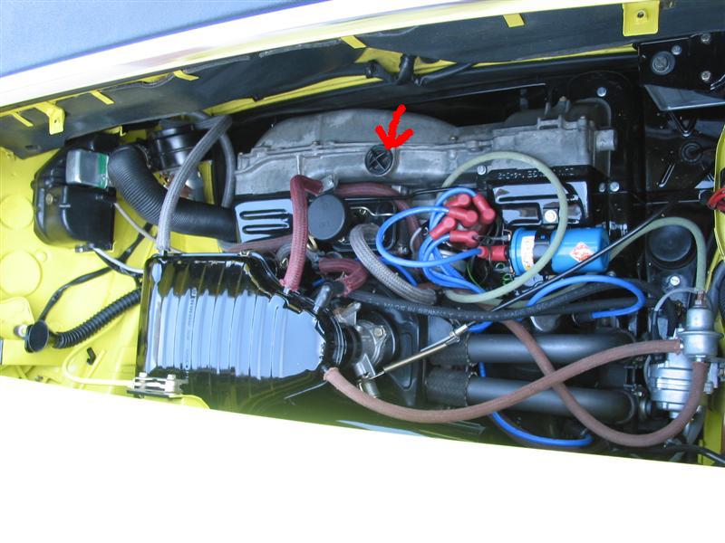

JeffBowlsby
post Jan 15 2006, 08:15 PM
Posts: 9,236
Joined: 7-January 03
From: San Ramon CA
Member No.: 104
(IMG:http://www.914world.com/bbs2/html/emoticons/cool.gif)

OH MY GOD.... That guy detailed the inside of the fan housing. Pull the engine cover, so you can get your head in there and look towrdes the back of the car part of your bike. (IMG:http://www.914world.com/bbs2/html/emoticons/biggrin.gif) You should see a notch, thats is the timing point on the fan housing. The timing marks are on the fan and it spins at the bottom of the notch. I have seen 2 notches 1 towrdes the front and one towrdes the rear. The rear one has the timing marks. There should be a 0 at top dead center (TDC) and as the crank turns there should be a mark at 27* before (I think) TDC. That is the timing mark for full advance.

JeffBowlsby
post Jan 15 2006, 11:41 PM
Posts: 9,236
From: San Ramon CA
Member No.: 104

Ok...how do I attach an image...I'll show you what my engine area looks like....nothing like what you posted

Dude: Sorry, I'm a 173rd vet and we can work it out. Forget about the hell hole, we can work that out later. You need to look inside the hole that the cap on the fan housing screws into. That is where you find the timing marks.
