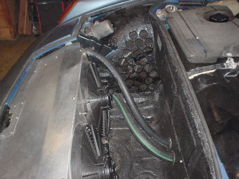

nick mironov   Started on the radiator first:   Jan 15 2006, 01:00 PM
nick mironov   Cut the front and isntalled the radiator and shrou...   Jan 15 2006, 01:01 PM
neo914-6   Nick, Great job, another Bay Area conversion...   Jan 15 2006, 01:02 PM

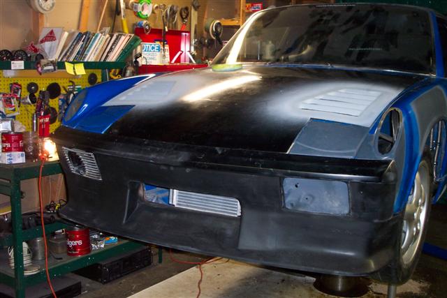

nick mironov   Another view of the radiator:   Jan 15 2006, 01:03 PM

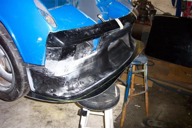

nick mironov   Cut the bumper:   Jan 15 2006, 01:03 PM
nick mironov   Finished front:   Jan 15 2006, 01:04 PM

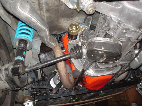

nick mironov   Installed. Right side before exhaust installation...   Jan 15 2006, 01:26 PM
nick mironov   Installed. Left side after exhaut installation. No...   Jan 15 2006, 01:28 PM

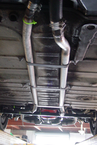

nick mironov   Coolant accessories:   Jan 15 2006, 01:29 PM
nick mironov   Carter electric fuel pump (noisy). The heater tub...   Jan 15 2006, 01:31 PM

dmenche914   Nice!!! So the radiator air exit is t...   Jan 15 2006, 01:38 PM

Crazyhippy   Very nicely done. My only concerns are: 1: The cu...   Jan 15 2006, 02:22 PM
r_towle   Awesome job, really nice work. Did you modify the...   Jan 15 2006, 02:35 PM
Dr. Roger   you can reduce the sound made by the fuel pump by ...   Jan 15 2006, 02:46 PM
nick mironov   As I mentioned, I have three hoods that I will be...   Jan 15 2006, 03:34 PM
messix   fuel pump: it looks like the pump to bracket is is...   Jan 15 2006, 03:49 PM
Andyrew   Hood venting will work fine only if you put a litt...   Jan 15 2006, 03:56 PM
dmenche914   Might be worth a try taping some ribbons on the ho...   Jan 15 2006, 04:16 PM
Andyrew   Nick, I'd leave the fuel pump alone... You wan...   Jan 15 2006, 04:43 PM

jd74914   Andy, I have no idea, the car isn't mine, but ...   Jan 16 2006, 01:26 PM
jd74914   And the bonding, kinda looks like this spoiler, m...   Jan 16 2006, 01:27 PM

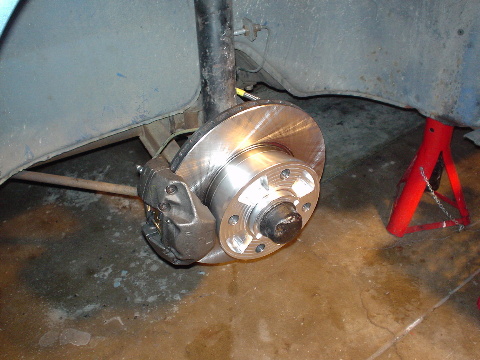

nick mironov   Upgraded the BMW 320i brakes to M-Calipers using M...   May 4 2007, 08:18 PM

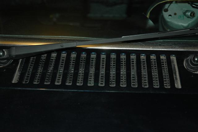

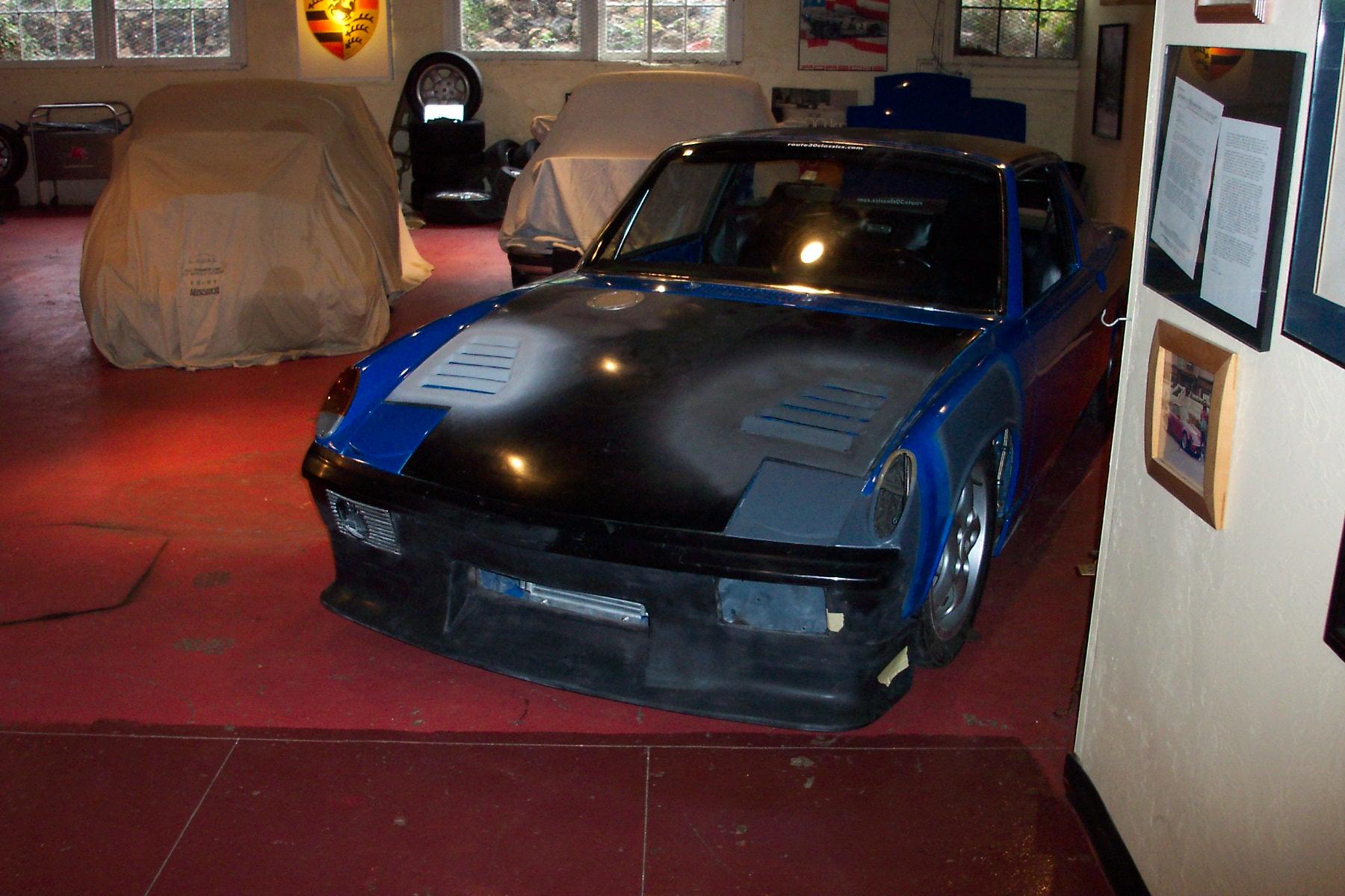

nick mironov   The hood vent experiment worked, but the heat flow...   May 4 2007, 08:21 PM

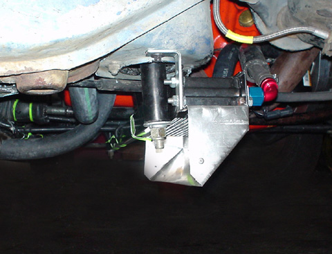

nick mironov   Added an oil cooler to the engine. I mounted it ho...   May 4 2007, 08:22 PM

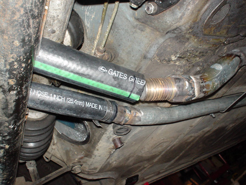

nick mironov   I changed the Renegade provided rubber hoses for s...   May 4 2007, 08:24 PM

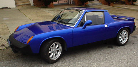

nick mironov   After lots of body work, and a spray-can prime to ...   May 4 2007, 08:29 PM
nick mironov   Back from the painter and finally re-assembled: Pa...   May 4 2007, 08:30 PM

jimkelly   shit - beautiful paint : ) I took my car today fo...   May 4 2007, 09:02 PM
DSM   I'd imagine that short stroke 283 twist up pre...   May 4 2007, 09:23 PM

Crazyhippy   The front bumper inlet is perfectly fine. I reall...   May 4 2007, 10:11 PM

Justinp71   Looks nice... Maybe a 911 front suspension clip wo...   May 10 2007, 01:38 PM
Root_Werks   :trophy: Nice! Can't believe I haven...   Aug 1 2008, 09:31 AM
Wanna9146   I know it's too late, but my Pantera has two (...   Aug 1 2008, 10:09 AM
jt914-6   What he was talking about with the heat getting in...   Aug 1 2008, 12:05 PM
Wanna9146   What he was talking about with the heat getting i...   Aug 1 2008, 12:19 PM
jt914-6   As far as I know, fresh air always comes in from t...   Aug 1 2008, 04:17 PM
3d914   IIRC you also have to close the two side vents, as...   Aug 1 2008, 05:49 PM
