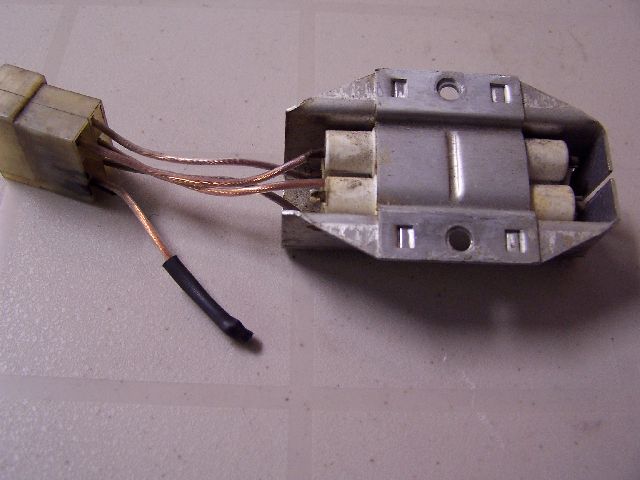

boxstr   Here is what one looks like. CCLINSHOWME   Jan 15 2006, 10:12 PM
boxstr   Okay never mind. CCLINOKAY   Jan 15 2006, 10:13 PM

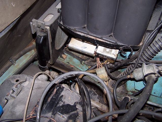

2-OH!   Broken wire/connection at the injector connector(s...   Jan 16 2006, 02:07 PM
dlo914     Jan 16 2006, 02:15 PM
dlo914     Jan 16 2006, 02:17 PM
boxstr   The one on the left.   Jan 16 2006, 02:19 PM
