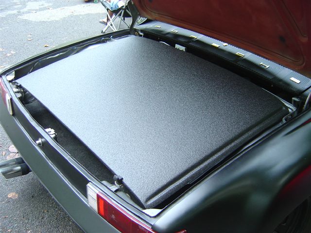

Here's mine, it was really bad before I recoated it. Areas in the back had cracked and there were some waves (highs and lows) in it. Sorry I didn't take before pics. I sanded it all out with an airfile then took it over to the truck bed liner guy "LineX". He did in a day for $75. I really like it. Durable and looks good. (IMG:http://www.914world.com/bbs2/html/emoticons/biggrin.gif)
