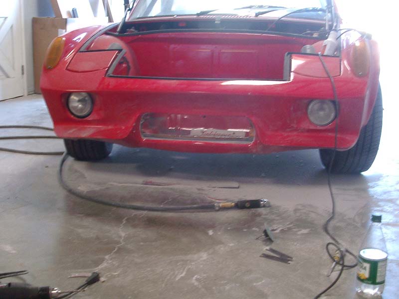

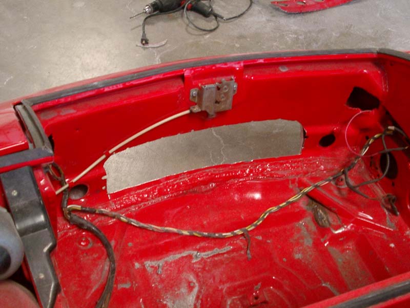

and the cutout in the 916 bumper for the air inlet ... it's just a rough cut for now as i'm still waiting for some parts, including the actual cooler ...
in the second pic, you can see the exit holes for the lines where they come through from the pass. compartement ...

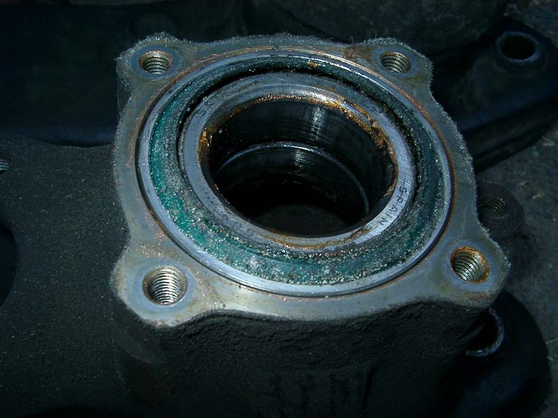

but first, let me show you one more reason why i think sandblasting your car is not a good idea:
rear wheelbearing, made a nice crunchy noise when turned by hand (IMG:style_emoticons/default/barf.gif)

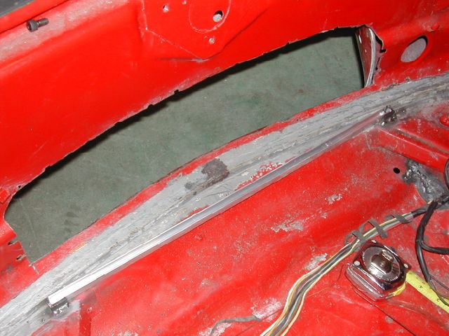

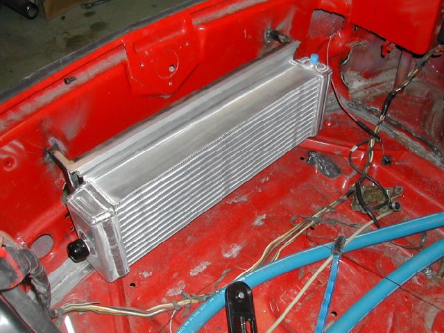

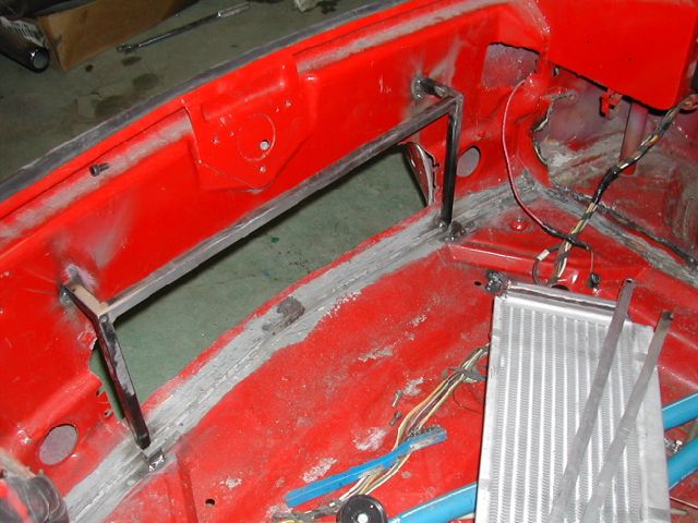

front oilcooler testfitting ...
first, the bottom channel with the welded tabs to hold it in place:
next, the frame the cooler is going to seal against in the front:
and finally, the first test fitting of the cooler, worked out very nicely:
and special thanks to McMark for all the help!
