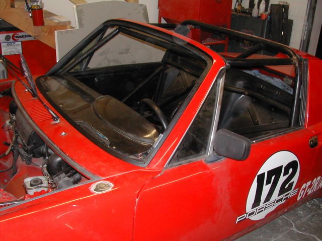

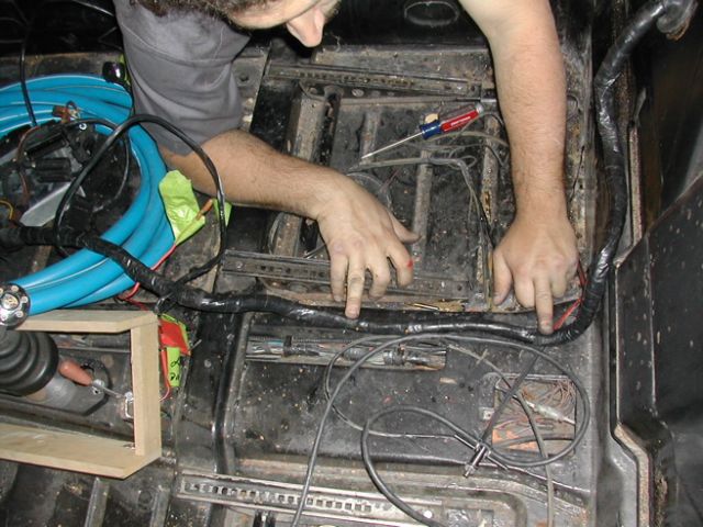

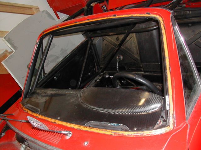

alright, time to start a conversion thread. i picked up the engine a month ago and started with the prepping of the tub today.
didn't get too much stuff done, oh well, babysteps ...
the ToDo-List (striked-out items are done!):
i'm going to overhaul the suspension, mount a front oil cooler with fan(s), fix a few spots on the tub the PO had hacked together, add racing seats and 5-point harness, install the 944 axles, the 911 eBrake, the new trailing arms, add a rear sway bar, Mueller roller bearings, new 250lbs springs on adjustable perches, fix the front sway bar, install new rear window, fix the gastank (correctly this time), replace the plastic fuel lines, get a trick porsche motorsports setup for my oiltank, add a vent to the front hood, redo the rear spoiler (ducktail), 100mm wheel studs all around, throw in the 3.6L motor and when all that is done, i'm going to give her a one of a kind paintjob!
oh, and i'm still playing with the idea to have her put on a celette bench to make sure she's straight ...
ETA: soon enough to run a full season for 2006 2007 !!! (IMG:style_emoticons/default/ohmy.gif) (IMG:style_emoticons/default/screwy.gif) (IMG:style_emoticons/default/biggrin.gif) (IMG:style_emoticons/default/driving.gif) (IMG:style_emoticons/default/aktion035.gif)
UPDATE: current todo list can be found HERE: todo list as of 04/25/07
This post has been edited by SirAndy: Jun 4 2012, 12:04 PM

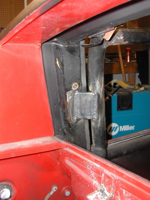

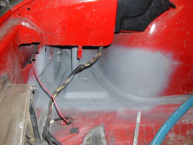

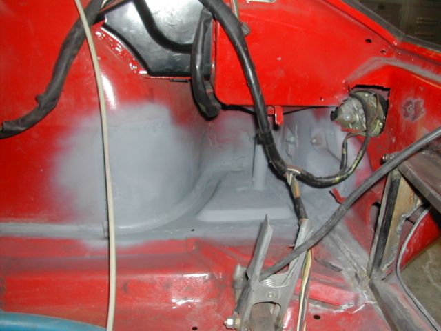

SirAndy   underside, prepped for mounting bracket:   Jan 22 2006, 10:42 PM
SirAndy   trunk support plate welded in:   Jan 22 2006, 10:43 PM
Howard   Hey Trek, if Andy gets a car that's fast enoug...   Jan 22 2006, 10:44 PM
SirAndy   mounting bracket welded in:   Jan 22 2006, 10:44 PM
SirAndy   McMark welding ... http://w...   Jan 22 2006, 10:45 PM
Howard   Seriously, that is a winner!   Jan 22 2006, 10:45 PM
SirAndy   after metal ready and primer ...   Jan 22 2006, 10:46 PM

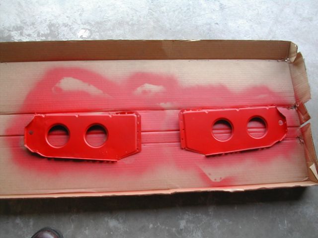

SirAndy   more "babysteps" ... got off to a slow start, did...   Feb 4 2006, 11:03 PM
SirAndy   took like 2 hours to get the two sides separated ....   Feb 4 2006, 11:04 PM
SirAndy   mark convinced me those would be much nicer all cl...   Feb 4 2006, 11:05 PM
SirAndy   and then some primer, so they don't turn into ...   Feb 4 2006, 11:08 PM
