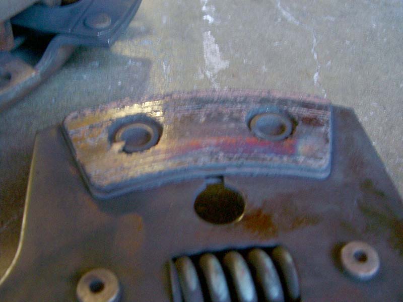

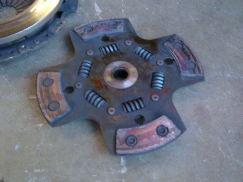

old clutch ... (IMG:style_emoticons/default/ohmy.gif)
can you see the burn-marks? (IMG:style_emoticons/default/blink.gif)
(IMG:http://www.914world.com/bbs2/uploads/post-179-1185423026.jpg)
fuzzy closeup: (IMG:style_emoticons/default/icon8.gif)
(IMG:http://www.914world.com/bbs2/uploads/post-179-1185423047.jpg)

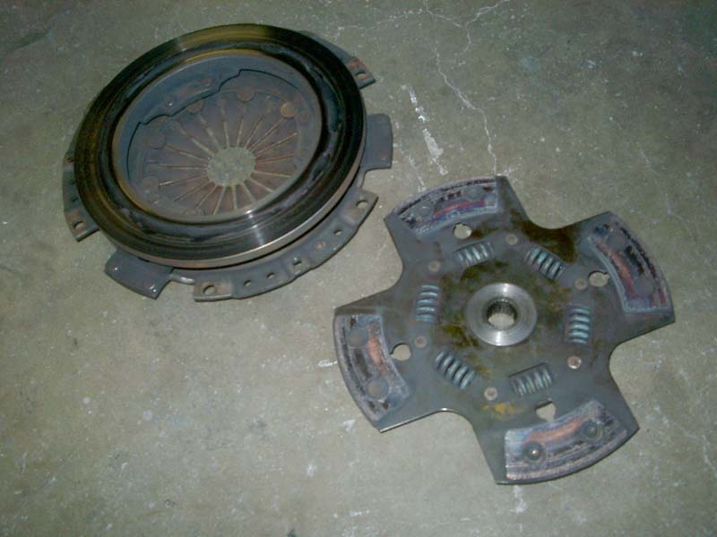

burned the pressure plate as well: (IMG:style_emoticons/default/barf.gif)
(IMG:http://www.914world.com/bbs2/uploads/post-179-1185423089.jpg)
what's all that dust falling out of there? (IMG:style_emoticons/default/sheeplove.gif)
(IMG:http://www.914world.com/bbs2/uploads/post-179-1185423131.jpg)
(IMG:style_emoticons/default/headbang.gif) Andy

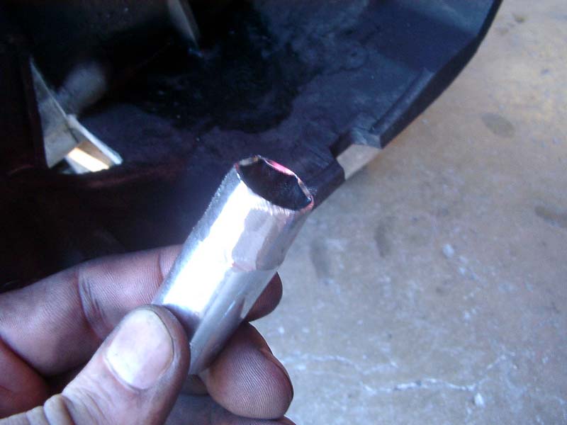

custom tool i made to remove/install the ball socket for the clutch lever pivot. 14mm socket that needs to be ground down to fit.
(IMG:http://www.914world.com/bbs2/uploads/post-179-1185423295.jpg)
and installed (IMG:style_emoticons/default/smilie_pokal.gif) :
(IMG:http://www.914world.com/bbs2/uploads/post-179-1185423324.jpg)

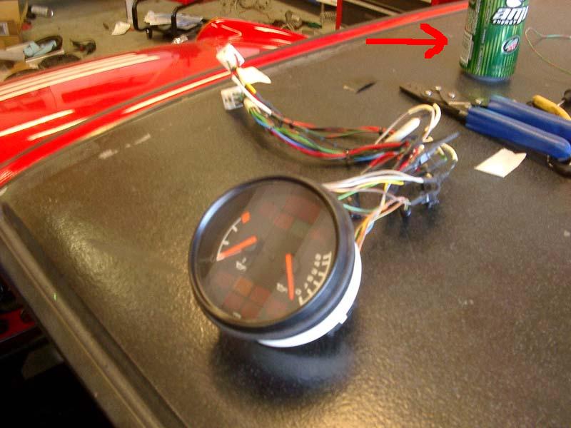

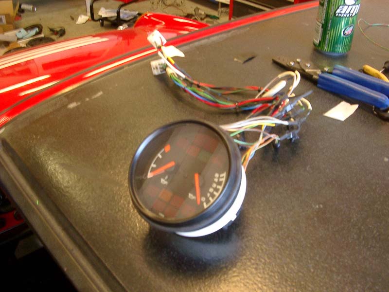

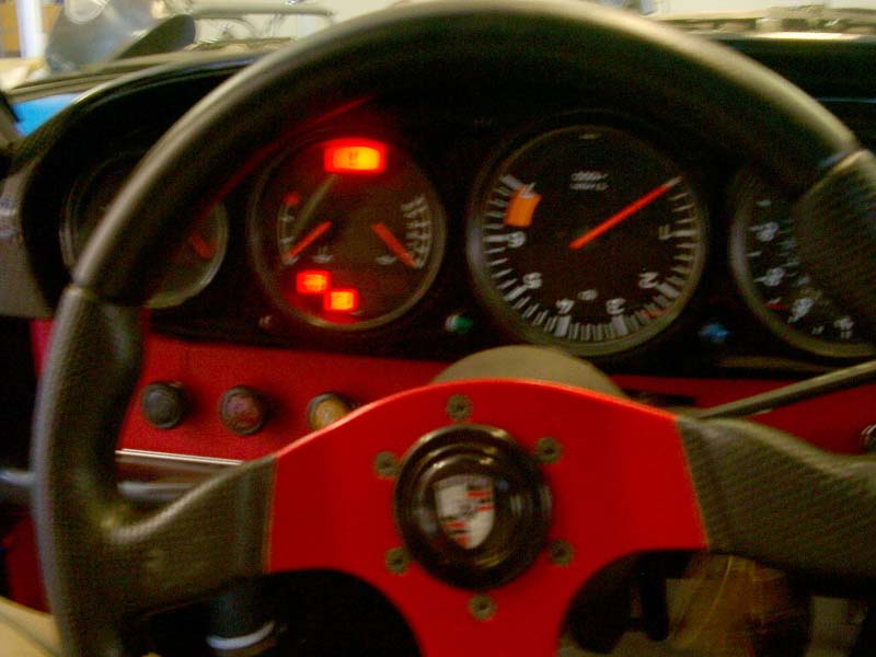

new 993 combo gauge. now i got the right gauge for the oil sending units. also hooked up the "check engine" light ...
wired and ready to go:
fuzzy closeup of them warning lights:
(IMG:style_emoticons/default/piratenanner.gif) Andy

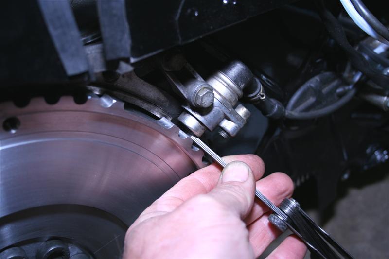

I assume you're talking about the sensor on the flywheel. In which case the bracket is stock 993. All i did was to notch the 901 bellhousing in the right place for the sensor.
As for the 944 axle conversion, there's a thread with all the details in the classics forum ...

An FYI....The conversion flywheel is smaller than a 993 making the sensor gap too big unless you machine the bracket for the sensor to drop deeper...see pictures
Mine worked just fine ... (IMG:style_emoticons/default/confused24.gif)
I set the gap to the factory specs and the adjustment on the stock bracket was more than enough. No machining needed.
(IMG:style_emoticons/default/popcorn[1].gif) Andy
