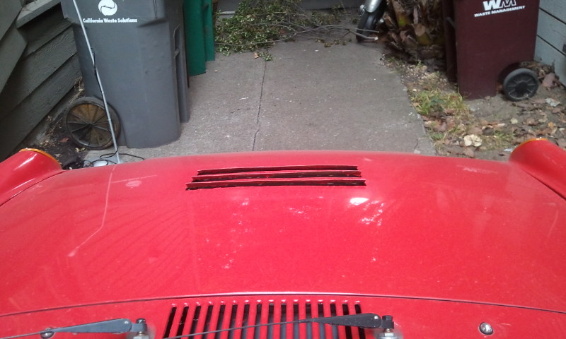

post Jul 22 2013, 11:50 PM
Post #298
Resident German
Posts: 42,560
Joined: 21-January 03
From: Oakland, Kalifornia
Member No.: 179
QUOTE(SirAndy @ Jul 21 2013, 07:00 PM) *
It's a bit "rough" but works very well ...

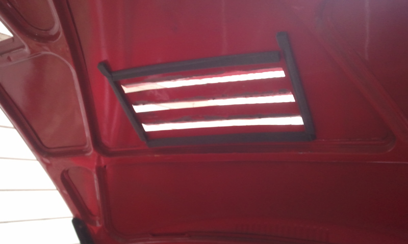

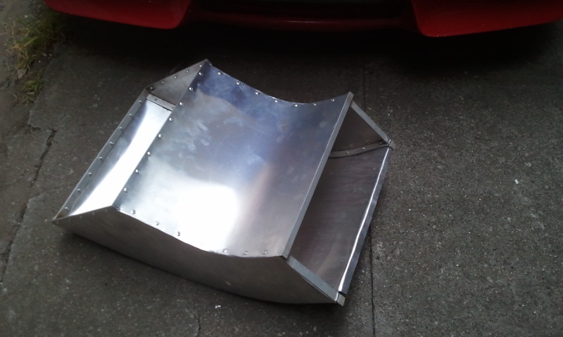

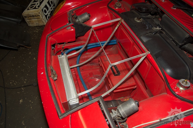

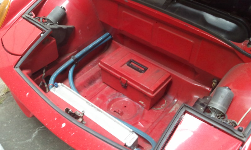

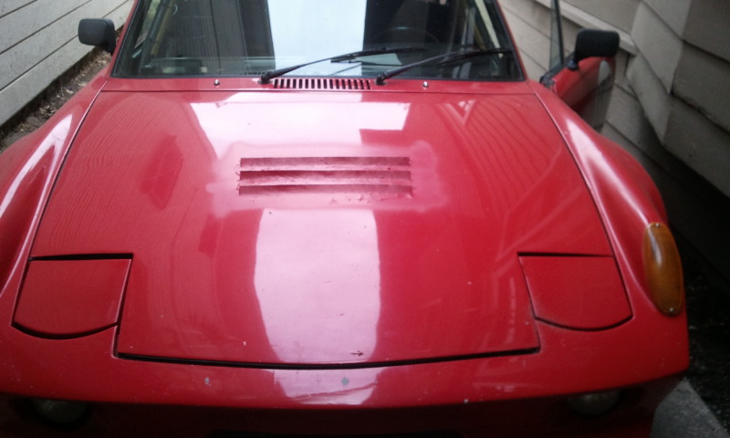

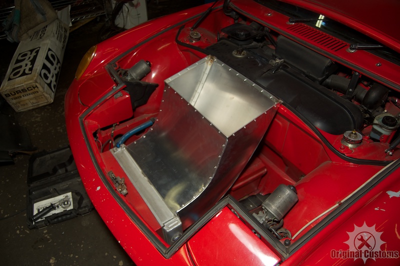

Alright, as promised, here are the pix ...
View from the front
View from the top
The shroud in place
The hood from the underside
The shroud removed
The shroud
Since this hood is all bend up anyways, we just went ahead and cut the louvers directly into the hood.
The final design will have a nice stamped (or FG) louvered section.
As mentioned before, the shroud is slid into position from the top and is only held in place by the closed hood.
It's very simply to take out (just lift it up).
The improvement in cooling is almost too much (see my other thread about the car not getting up to operating temp).
I also noticed a significant improvement in high speed stability, i'm guessing due to less air under the car and added downforce from the out the hood design.
bulitt
post Jul 23 2013, 03:02 AM
Post #299
Achtzylinder
Posts: 4,189
Joined: 2-October 11
Member No.: 13,632
Nice. Mini-ferrari type set up. The 308's and 512's didnt have a shroud, the front trunk bulkhead just acted as a wall to direct air up through the louvers, and as you did- Ferrari just used a strip of foam to seal the area. I would think the shroud will keep water out of the trunk to some extent, if you ever drive in the rain. I may go this route to vent my radiator and keep the wheel structure intact. Have a spare hood to mess with.
