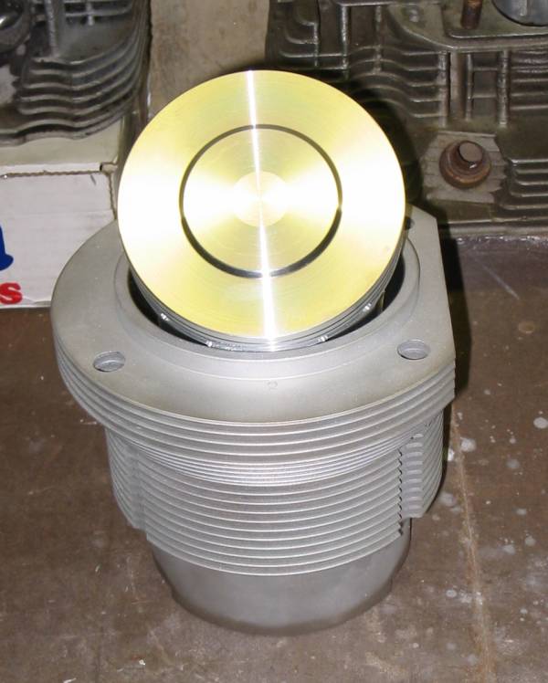

I want to make a good showing at my first SCCA National Runoffs so I decided to upgrade my backup engine. (I don't have a real race engine right now.) I'm installing my 94mm Nickies set

and the JE pistons with stock dome shape.

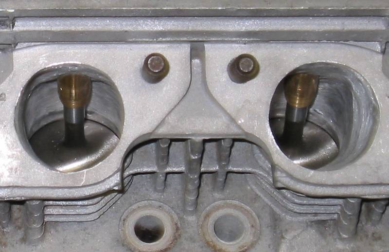

I got some stainless valves and decided it was time I started learning how to port my own heads.

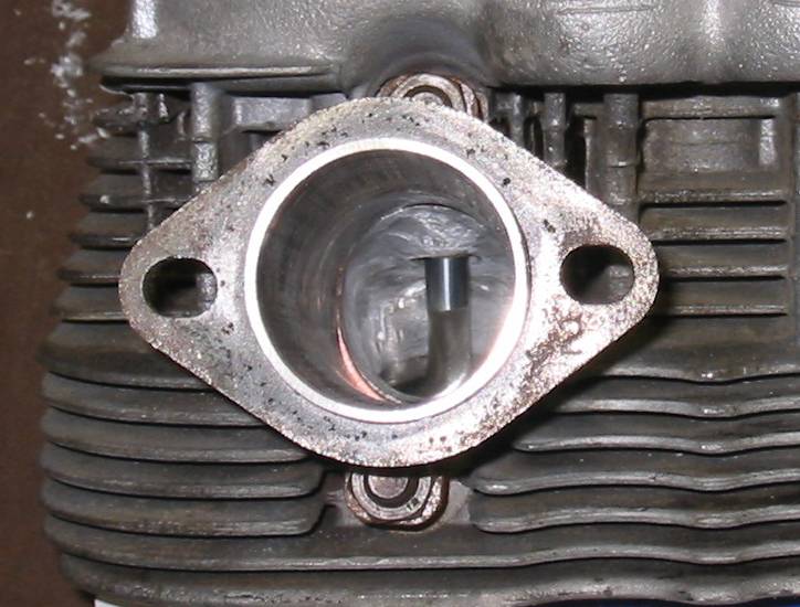

I'm having a lot of fun doing this.

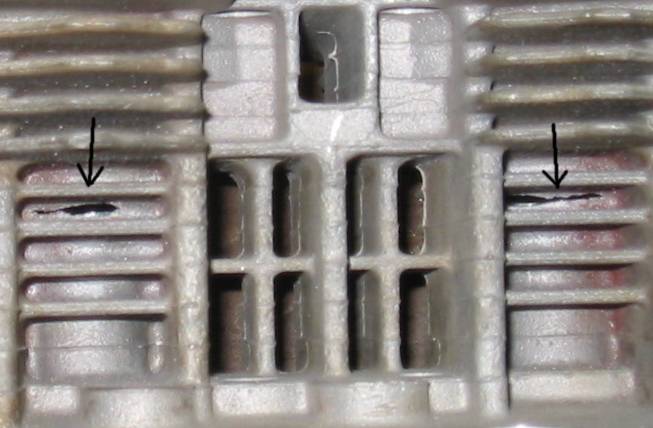

It's important to know where NOT to remove material

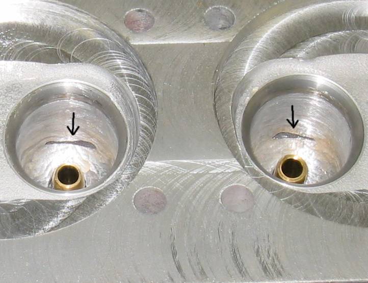

Oops! It's a good thing I know a talented welder (IMG:style_emoticons/default/blink.gif)

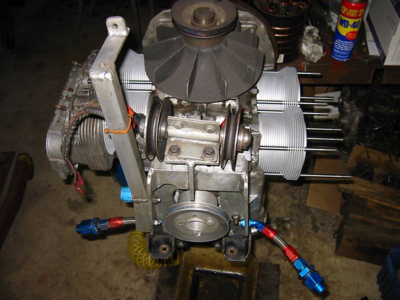

QUOTE(URY914 @ Aug 30 2003, 02:56 PM) Chris, Tell me about your fan set up. I've read the discription on you website, but what are the advantages? More air? Lighter than the stock fan and housing? Drains less HP? What gives? Wish I was going to the Runoffs. Good Luck!! (IMG:style_emoticons/default/smilie_flagge24.gif) Paul The Corvair fan setup wasn't my idea, but when I saw it I was immediately attracted to the design. It is way lighter than the stock system and most of the features of the stock system are superfluous on a race car. I don't have the stock oil cooler or the heat exchangers or an alternator. I don't need to preheat the engine either. I don't know if it actually cools better or draws less power - wish I had known Raby was doing a comparative test of cooling systems recently. I would have made an extra effort to supply him with one of my setups for his testing. I do know it works fine at keeping head temps under control, and I have won races. So it isn't drawing too much power for me at this stage. One possible shortcoming is that it must run at 1 to 1 speed off the crankshaft, but so does the stock system. I never liked the idea of using the modified 911 cooling setup. For one reason the alternator is the fan hub. SCCA rules require the alternator, if used, to be in the stock location. Also it draws a lot of power and pushes too much air, but not uniformly over all 4 cylinders. If I had known about the DTM when I built my Prod car, I might have gone that route. However I really like the low profile of the flat fan, and I am reminded of 917 cooling systems with the horizontal fan. (IMG:style_emoticons/default/clap56.gif) Thanks! |

The more I see guys tearing their engines apart, the more I think, "Gee, I could fail at that!".
(IMG:style_emoticons/default/smile.gif) I like the hz cooling, do you know of anyone with it on a 914/6? I have a friend with a 935 that has it, but it's crammed in there with too much other stuff to imagine it fitting in a 914. M |
