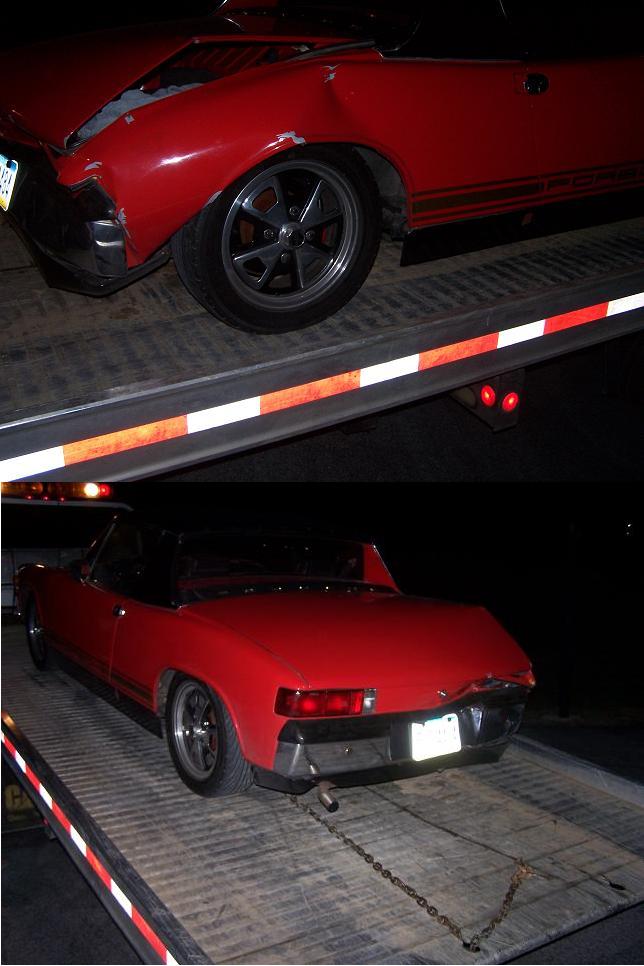

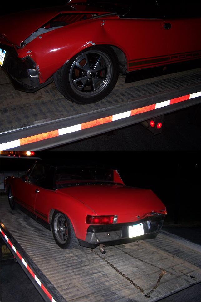

I just needed to pound out a few dents to get Big Red back on the road.
Here's a couple of before pics.

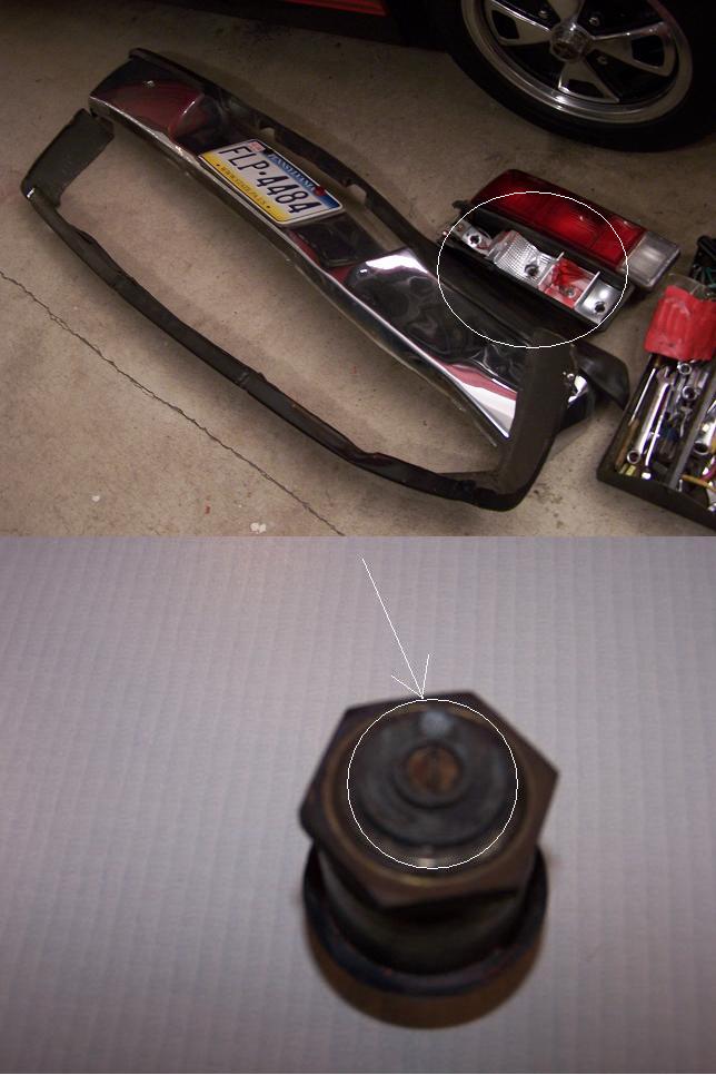

Picked up a chrome bumper in Jersey. $10 from Ebay. Someone mounted a trailor hitch to the car so there's some extra holes on each side. The bumper's very solid.
