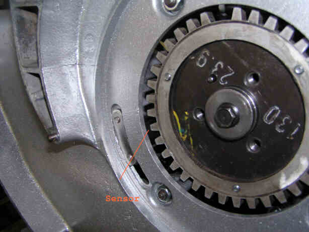

Hey R2.0, here's what I did. I takes the place of the washer behind the fan
Dave
