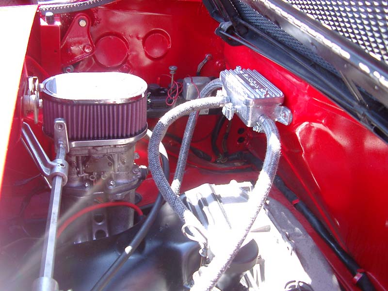

QUOTE (yarin @ Feb 6 2006, 08:28 AM)
Yea i figured that. There is no vent box on my car.
What connects to the vent box? Left head, right head and the vent next to the oil fill?
like so ...

Is there a breather on that? Filter? What's the internal construction?
I'm guessing its a do-it-yourself item with either welding skills or PVC. (IMG:http://www.914world.com/bbs2/html/emoticons/blink.gif)

they have a metal perforated screen, then a foam element.
the lid is "offset" so the pressure vents from between the lid and the case...

your supposed to mount it high enuff where it will drain back into the heads.....

CB Performance unit. has a filter element in it. any oil vapors that make it up there will be collected and drain back into the oil-filler ...
btw. depending on the engine RPM the head vents sometimes SUCK in air ...
