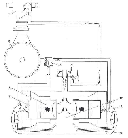

While pulling my carbs off I noticed that each head has an air vent. One was capped off, the other was open.
Where should these go and why are they needed? Will capping these contribute to oil leaks?

yarin   Head vent ports   Feb 6 2006, 10:07 AM
ClayPerrine   You need the head vents to keep from building exce...   Feb 6 2006, 10:11 AM
yarin   Yea i figured that. There is no vent box on my car...   Feb 6 2006, 10:28 AM

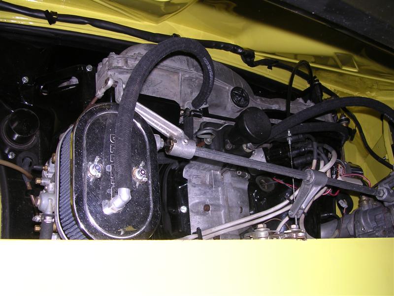

yarin   Is there a breather on that? Filter? What's th...   Feb 6 2006, 01:16 PM
Aaron Cox   they have a metal perforated screen, then a foam e...   Feb 6 2006, 01:25 PM

dmenche914   Basically the crank case vent vents the case, and ...   Feb 6 2006, 08:16 PM

Brando   http://www.914world.com/bbs2/ht...   Feb 8 2006, 02:35 PM
914efi   I was thinking that if you hooked the vent up to t...   Feb 8 2006, 02:57 PM
dmenche914   If I read that the way you meant, hooking up the a...   Feb 8 2006, 03:29 PM
Mueller   on my old L-Jet, I machined Delrin plugs to fill u...   Feb 8 2006, 03:35 PM
dmenche914   So Mikes car with l-jet ought to be able to run ju...   Feb 8 2006, 03:58 PM
