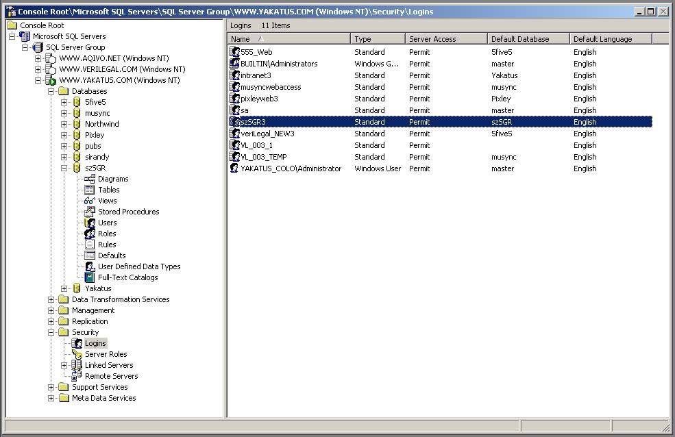

QUOTE (richardL @ Feb 6 2006, 04:07 PM)
I have never seen a DSN with NT authentication simply provide access to another database - it should tell me I don't have access rights to the database selected or whatever.
that actually has nothing to do with the DSN setup. if the user account they gave you has no restrictions, you'll be able to use it to access any database on the SQL server.
if the account was only supposed to be used with one specific database but actually works with others as well, the account is set up incorrectly ...
you specify which user can access what database devices (see pic 1) and you also set a "default" database for that user (see pic 2) ...
so, maybe, the useraccount you are using is not configured correctly ...
(IMG:http://www.914world.com/bbs2/html/emoticons/type.gif) Andy

post Feb 6 2006, 11:39 PM
