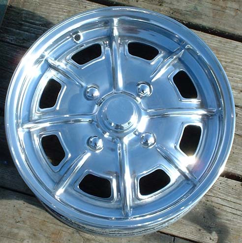

I've got a set of very weathered Pedrinis on my 14. Setting aside, for now, the obvious way to improve their appearance (5-lug conversion, duh), can I get any suggestions on refinishing?
Powdercoat -- cheap (~$75/wheel), durable, attractive, but there is some speculation that the baking process might affect the strength of the alloy
Paint -- probably the best way to duplicate the factory finish, but surprisingly expensive (~$150/wheel), and of dubious durability
Polish -- don't know about expense (maybe the same as powdercoat?), looks good initially, but requires continual attention
Thoughts, vendors, other options?

Al and Diane can do pretty much whatever you want. Or certainly everything on your list. Give 'em a call.
Al Reed Specialty Polishing
3010 E. Coronado #A
Anaheim CA. 92806
714-632-3907

i decided to sandblast and polish my set of mahles. they look great, but i do not recommend it, have someone else do it. even with a dremel contour sander it takes 8-10 hours per wheel. (IMG:http://www.914world.com/bbs2/html/emoticons/ohmy.gif)

I sent mine to Al Reed. It was awhile back, but I think he charged something like 75 a piece? Not sure, but they turned out amazing.
