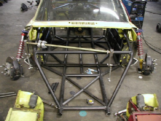

quick midweek updates - not much to see, he just started framing out the front.
Brett - turns out I mentioned the ZR2 stuff to AJ and asked if he knew what I was talking about and he said "yeah, that is the mini-stub stuff I have been trying to tell you about" (IMG:http://www.914world.com/bbs2/html/emoticons/rolleyes.gif) So he had shown me some of the aftermarket stuff they have been using a ton of on bajas - apparently it has the GM hubs and such.

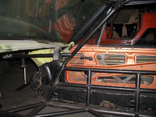

tubing passing through the old vent areas. The car metal will ultimately be removed that surrounds the tubing - we just kept in in to have a reference of where the dash vent hole will be in the end.
