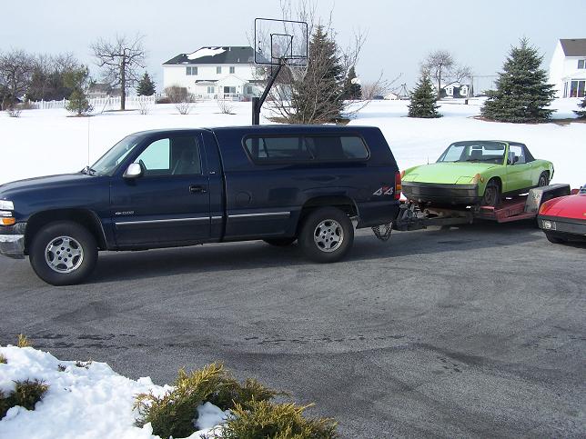

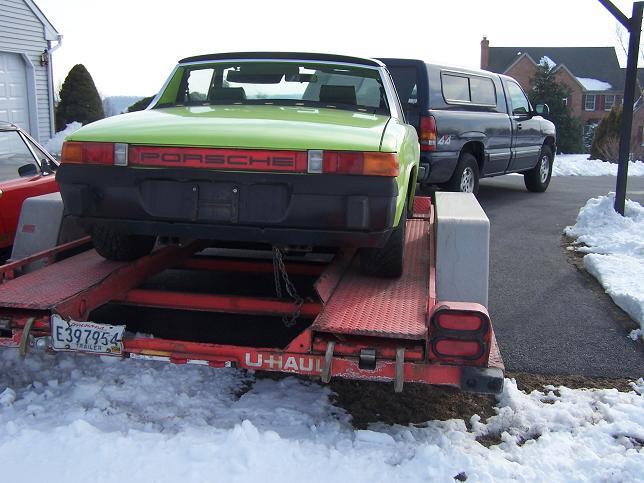

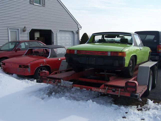

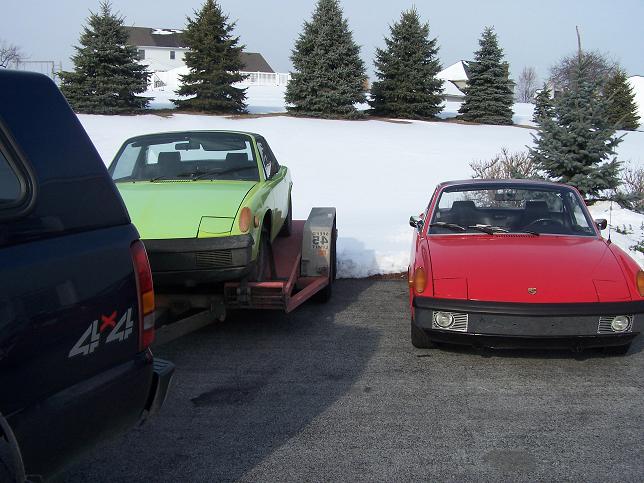

This was the first time that I've towed a car on a trailor. My buddy's 1500 Silverado pulled the 914 very easily. I kept the speed low, between 55 and 65. The ride from my house to the car in Connecticut was about 180 miles.
At 55-65 MPH, I was a moving chicane on rt 287, rt 78 in NY and NJ. I could see semi trucks 1/2 mile behind me start to make moves when they saw me turtling along up ahead.

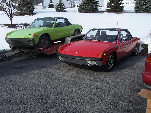

The paint for the most part appears to be original. The hood looks like it was painted once, but fenders, doors, and jams still have original paint on them.

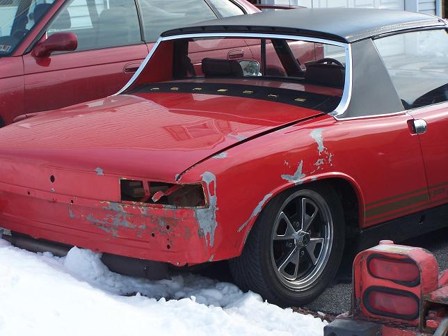

The red car is starting to look like it did a month ago before the accident. Taking my time on pounding out the damage. I'll get the red one back on the road then decide whether to sell it or keep it.
Spoke
post Feb 17 2006, 08:24 AM
Jerry
Posts: 7,370
Joined: 29-October 04
From: Allentown, PA
Member No.: 3,031
The wrinkles are slowly disappearing. The car still runs good. Can't drive it anywhere except in the neighborhood. No insurance, no registration.

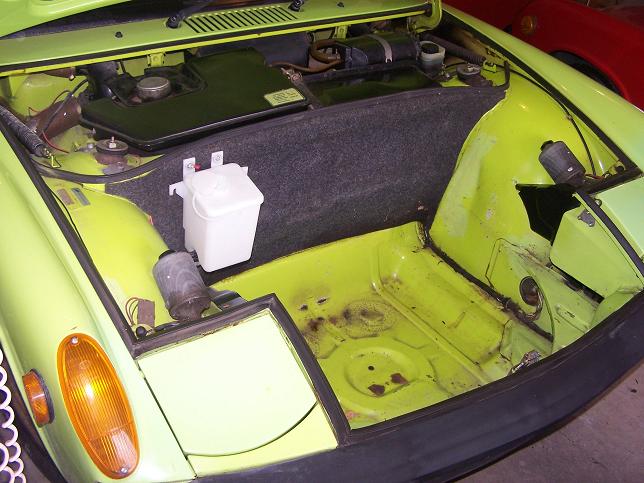

Front trunk is very clean. Don't like the electric window washer. I have the original washer bottle. Maybe I'll retro-fit the electric washer motor into the original bottle.

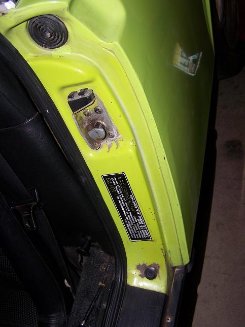

Door jams have original paint. The car was undercoated. I think this is why the car is in such good shape. One of the negative points of '70s undercoating can be seen in the plug near the door sill. The drilled hole allowed surface rust to begin. The positive point of undercoating is that the structure of the car is in excellent shape with very little rust. The car alledgedly has 137K miles.

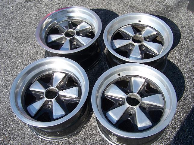

The car will be 5-lug. These 7-inch and 8-inch wheels will add some bling to the car. I'll strip, polish, and paint the wheels. Need to get some center caps.
I polished up one spoke and part of the rim on the the top left wheel just to see it shine. Looks nice.

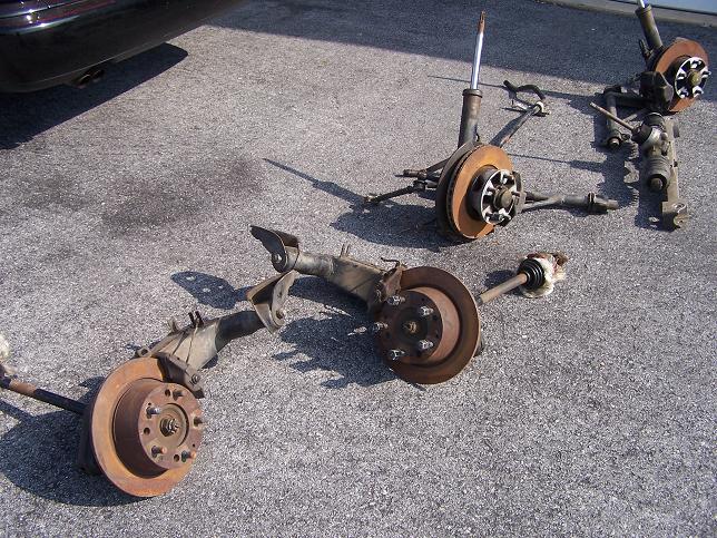

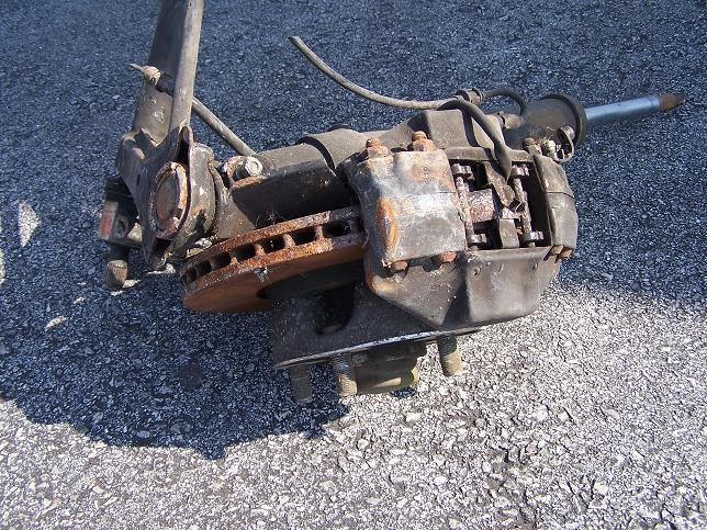

Just scored this set up from ebay. Picked it up in Long Island today.
911 Carrera front end includes a-arms, torsion bars, aluminum crossmember (with horn attached), sway bar, struts, rotors, calipers, tie rods, and steering rack. Seller thought it was from a mid to late 80's 911.
Rear end includes swing arms, complete axles w/inner/outer CVs, 4-to-5 lug converted hub and rotor, 914-4 caliper.

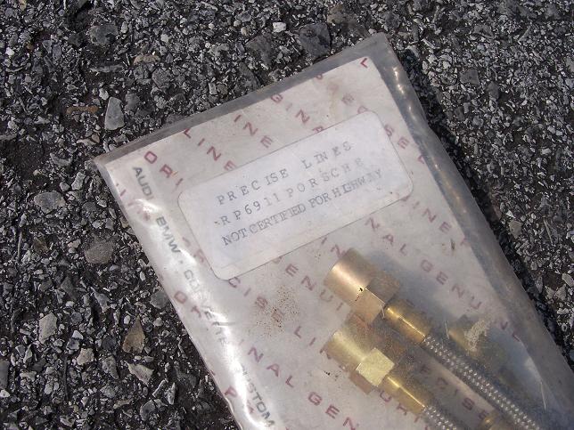

These braided brake lines were also included.

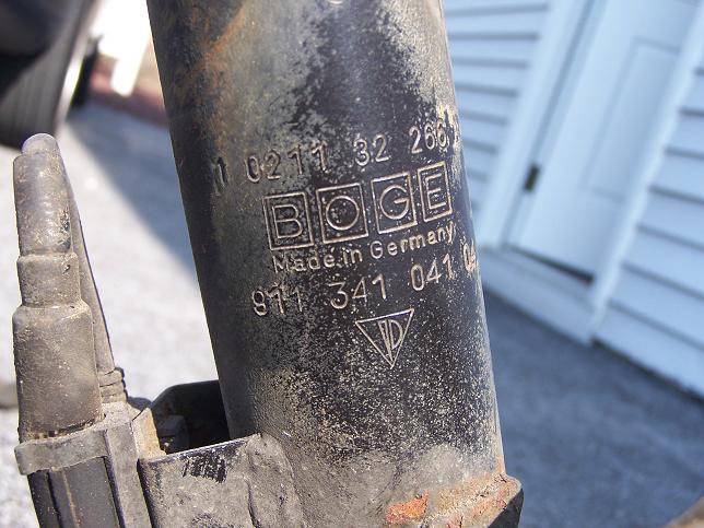

Here's the numbers on the struts. Boge shocks? duh. Will the adjustable Koni's on my stock 914 fit in these?

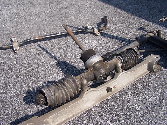

The far bellows on the rack has been chewed by mice. Should I consider using this rack or stay with the one on my 914? Would this one be better?
Spoke
post Feb 25 2006, 12:37 PM
Jerry
Posts: 7,370
From: Allentown, PA
Member No.: 3,031
The calipers have 3.5 inch spacing between mounting bolts. The body of the calipers are metallic. A magnet sticks to the body of the caliper so I don't think it's aluminum. Does this mean that it's an "A"?
The brake pads have wear sensors on them and its wires are secured to the strut. Hmm, can I use these for wear detection? I guess I need an idiot light somewhere.
