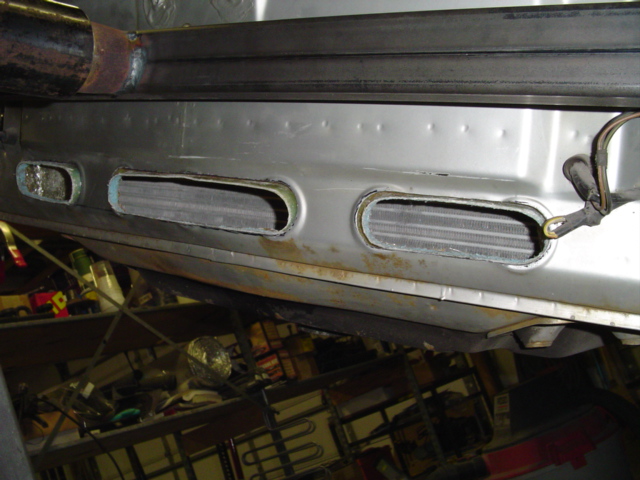

Started out by figuring out the mounting of the cooler itself. It's a very large (4 x 24 fin area) and I think a good fit for a 3.6 since it doesn't have an engine mounted cooler. I started by cutting sections out of the front support tray for clearance and then re-boxing the area to keep the shelf rigid and serve as a mounting point for the front of the cooler.
Here's a pic of the cut outs...........
East coaster   Oil cooler..........round two   Feb 17 2006, 07:56 PM
East coaster   other side....   Feb 17 2006, 07:57 PM
