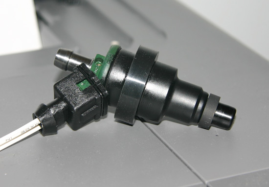

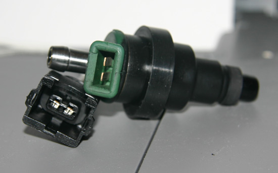

I got my injector connectors off ebay: link here
(IMG:http://members.cox.net/forrest280z/icclose.jpg)
here are my pics:
yarin
post Feb 27 2006, 09:44 PM
'14-X'in FOOL
Posts: 988
Joined: 13-May 03
From: Guttenberg, NJ
Member No.: 693
its a really snug fit. the metal clips on there dont hold them in.
here is another thread about injector connectors:
http://www.914world.com/bbs2/index.php?act=...321&hl=injector
so far so good!

Good point, however the fit between the connector housing and injector body is very tight. It takes a significant amount of force to insert/remove the connector. I'm going to shrink wrap the connector as well. If it works it works, if not i'll find out the hard way.
