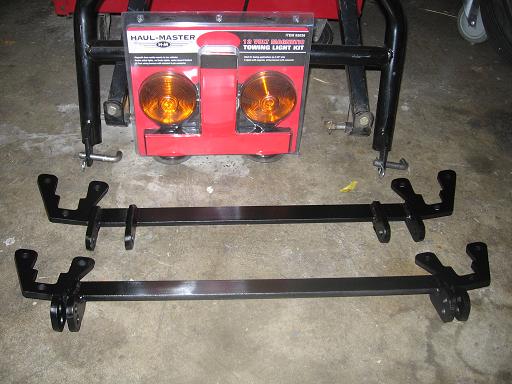

Tow bar brackets are now available.
More installed pictures to follow as users forward them..........
Click Here for Details.........

dlee1967   Welded race eye option shown on a Reese/Drawtite s...   Feb 28 2006, 11:27 PM

dlee1967   I have found that some tow bars may have pins that...   Mar 14 2006, 11:11 AM
STL914   <...   Mar 14 2006, 12:01 PM
dlee1967   Gary, my suggestion in your case would be DON...   Mar 14 2006, 01:13 PM
STL914   ...   Mar 14 2006, 02:15 PM

dlee1967   For those who don't want to use magnetic light...   Mar 23 2006, 09:05 AM

dlee1967   I've had a number of inquiries about how my br...   Mar 28 2006, 03:26 PM
dlee1967   Another variation in angle...   Mar 28 2006, 03:28 PM
dlee1967   Another safety minded 914 owner has asked that I a...   Mar 28 2006, 03:35 PM
dlee1967   another angle   Mar 28 2006, 03:35 PM
dlee1967   last   Mar 28 2006, 03:36 PM
dlee1967   916 cutout ideas   Mar 28 2006, 03:37 PM
dlee1967   straight on.....   Mar 28 2006, 03:37 PM
dlee1967   Last update for today! I have found that a co...   Mar 28 2006, 03:52 PM
