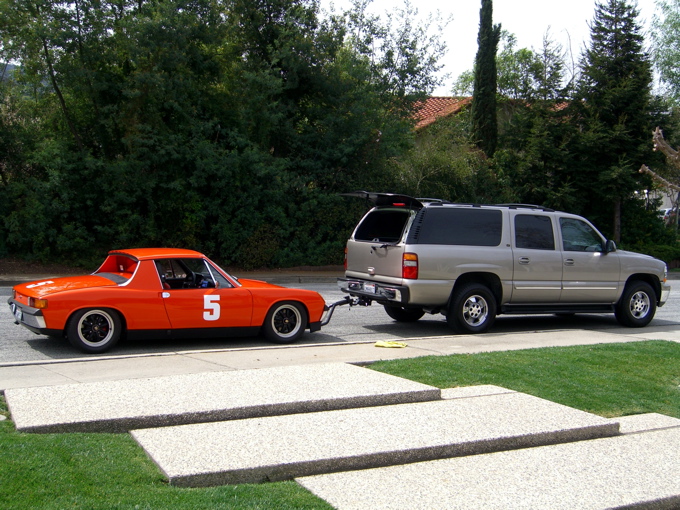

In these pics this was just the first test and I did not have my 4 inch drop draw bar on the Suburban. When towing the tow bar should be as close to level as possible...I will post another pic later with the more correct draw bar in place (IMG:http://www.914world.com/bbs2/html/emoticons/biggrin.gif)

or this

Quick update.
Used David's tow bracket and my super beetle tow bar to take my track car to Buttonwillow Ca from San Jose Ca last Saturday.
I am impressed. Car towed straight and true the entire time at all speeds including a few times in the 70mph range to pass some slower traffic.
almost 500 miles with no issues what so ever.
I have been towing RVs, boats, trailers and race car trailers for over 35 years and this worked beautifully.
I highly recommend this for all 914 owners that are wanting a clean, easy and inexpensive way to transport their 914.
Had several 914 owners admire the set up at the track event I attended. All thought it to be a very clean and elegant solution. (IMG:style_emoticons/default/smilie_pokal.gif)
