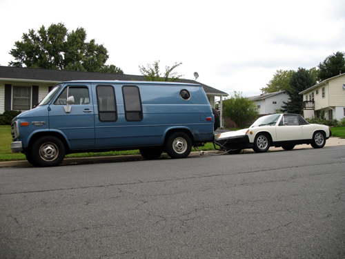

just returned from a round trip from VA -to des moines IA - and back to VA with 1975 914 attached to my 1989 van using David's empi tow bar mount - mounted fast and worked perfectly - every car should have one : )
thanks,
David

Thanks for the plug Jim. I am glad to hear that you had an easy tow home. Great find with that 914! Nice condition......
The tow vehicle with the fisheye window really completes the '70s look!
David Lee
