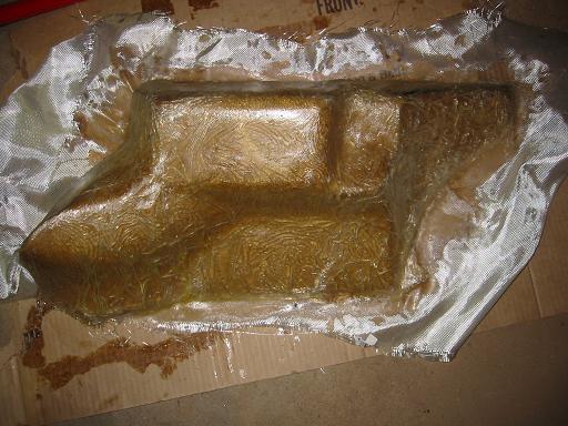

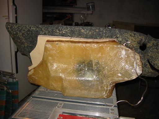

i posted the start of this like 3 weeks ago. I think it ended up looking good. I was amazed how much sound an 8in woofer would put out if set in the proper enclosure. The bass from the one 8in woofer can rattle the license plate.
pic attached
Start: took out the foam block under the passenger footwell and covered in plastic and then fiberglassed over that.

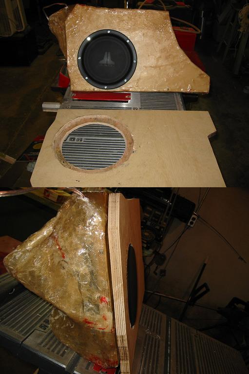

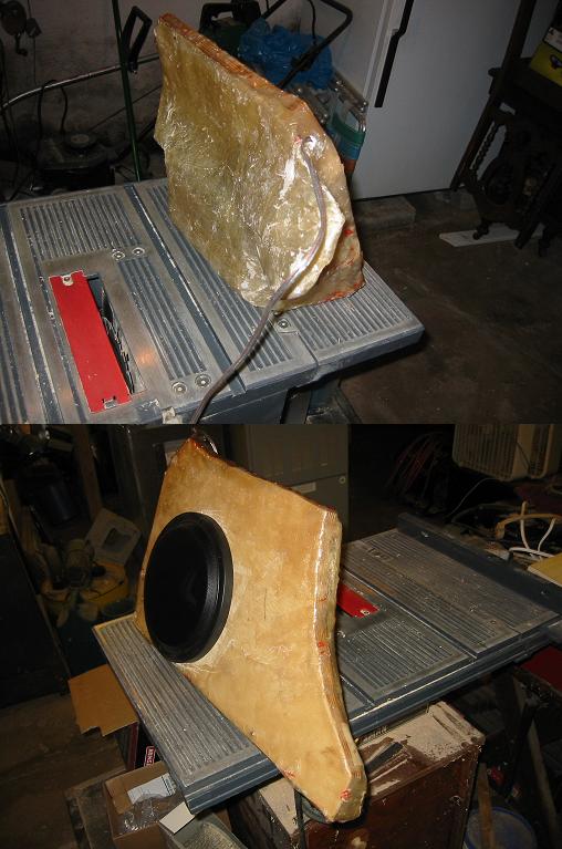

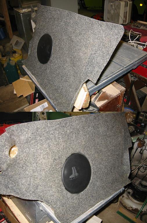

front and back speaker mounted
wilchek
post Mar 4 2006, 11:48 AM
Posts: 506
Joined: 8-June 04
From: Eastern Pennsylvania
Member No.: 2,177

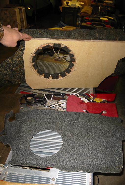

cover board to make carpet flush with speaker grill
wilchek
Posts: 506
Joined: 8-June 04
Member No.: 2,177
cover board carpeted
wilchek
post Mar 4 2006, 11:49 AM
Posts: 506
Joined: 8-June 04
Member No.: 2,177

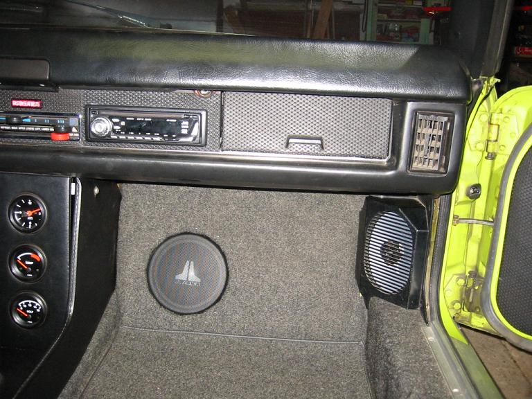

cover speaker completed- flush carpet with grill
wilchek
Posts: 506
Joined: 8-June 04
Member No.: 2,177

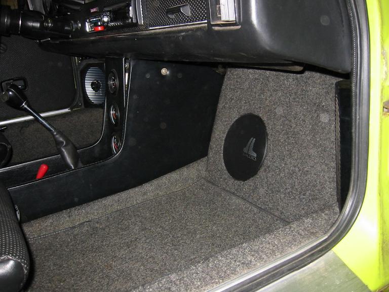

completed unit

Cool project! How much foot space does the passenger lose?

final box installed

another angle final

QUOTE (anthony @ Mar 4 2006, 01:50 PM)
loose only about 1 1/2 to 2". Not really noticable to me and I am 6 feet tall.

I was going to make more, but it takes too long to do all the layers of fiberglass. Also, I hate doing fiberglass. If you need any help making one let me know, I made a bunch of templates.
