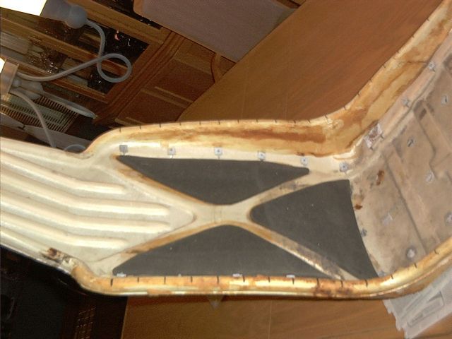

I stripped an 914 seat and i'll be adding more side support to it.
Here's a bare naked seat (you gotta flip your head!!!):

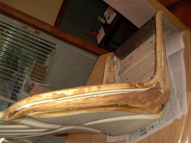

Backside (flip your head again!!!):

So in the second picture i traced a line where i'll be cutting the side of the seat (taking out the J shaped part). In the first pic, i'll slice the J shaped part where the black lines are keeping just enough material to keep it as one piece. I 'should' be able to form a new edge extending de side part. I'll glass them back to the back seat afterwards.
High density foam & recovering and I hope i'll have something that doesn't look to bad and give me plenty of support. I'm 6 feet tall and 210lbs. I'll try to make it not too tight!!!
For now i'm working with cardboard forms to figure out what i want.
Marc-André
