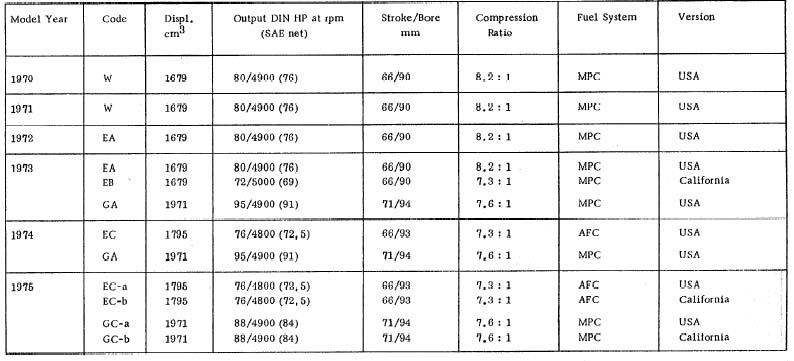

Bleyseng
post Sep 8 2003, 08:53 PM
Post #36
Aircooled Baby!
Posts: 13,037
Joined: 27-December 02
Member No.: 24
here is the compression ratio chart for all the years
