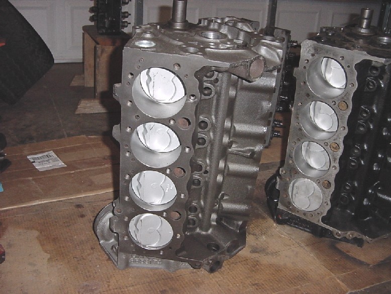

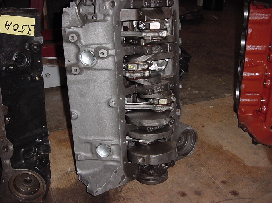

Road trip to Springfield MO this weekend yielded the following....
Fresh build SBC 302 with TRW 12.5 CR forged pistons and open chamber 441 2.02/1.6 heads...
dakotaewing
post Mar 19 2006, 12:13 PM
Post #26
Posts: 1,167
Joined: 8-July 03
From: DeSoto, Tx
Member No.: 897
Bottom End

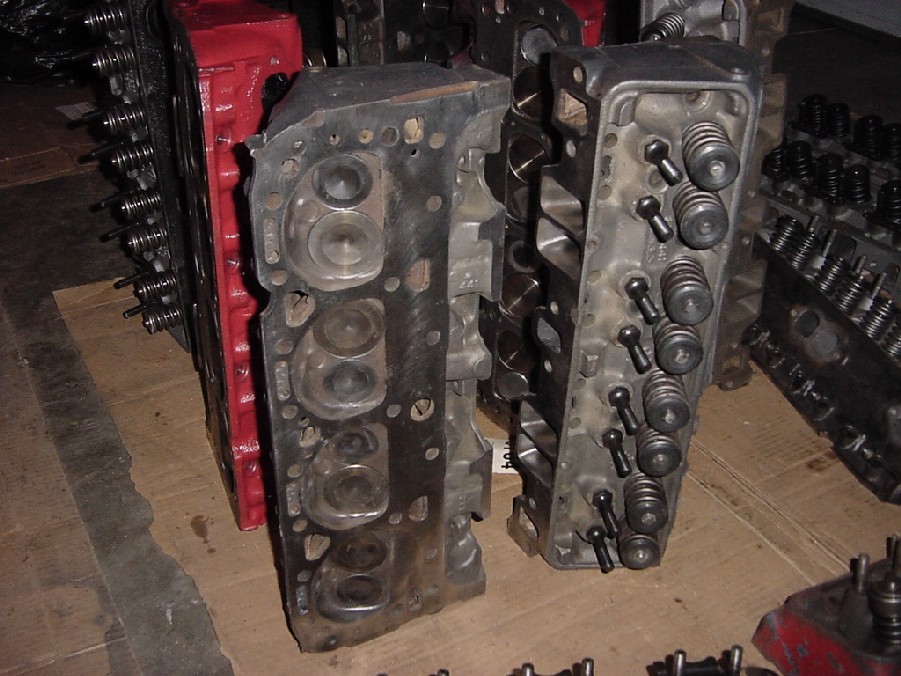

Heads...

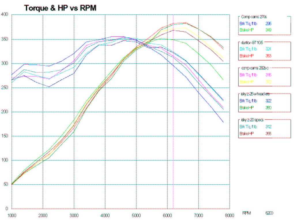

Been working on cam choices for the last few weeks, trying to determine which cam to use.... Looks like the Duntov -97 is the winner...
Pk TQ = 354@4600 RPMs Avg 302
Pk HP = 384@6600 RPMs Avg 253
What do you goes think ??? ..... (IMG:http://www.914world.com/bbs2/html/emoticons/happy11.gif)

QUOTE (Andyrew @ Apr 6 2006, 01:25 AM)
NOICE!!!
Thats pretty darn sick!
What did you pay for that engine?
Any more specs? thats about what I want..
Andyrew -
283 Forged crank
5.7" rods
Trw Forged 2210 12.5CR 4.060 pistons = 310 c.i.
441 open Chamber Iron heads w/ 2.02/1.6 valves
Ends up being rated @ 10.5 CR w dynamic compression @ 6.63 with the Duntov-97
Dynamic CR w/282S is 8.08
It will run with a dual plane manifold
650-750 carb
Headers
I ran all the cams based on this scenerio on Performance Trends engine analyzer to come up with the graphs for the power band.
If I get 20% less at the wheels, I should be in good shape -
My only concern at the moment is the valve lift is .578 on the Duntov - which may be way to much... I may be better off going w/ the 282S cam where the gross valve lift is .495

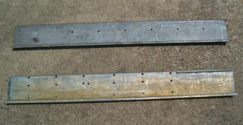

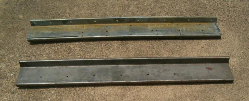

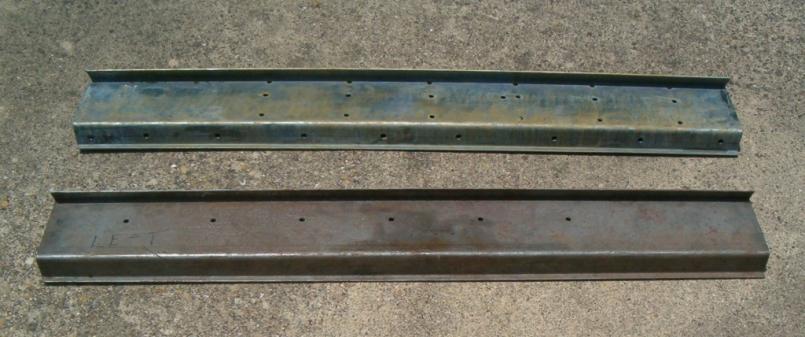

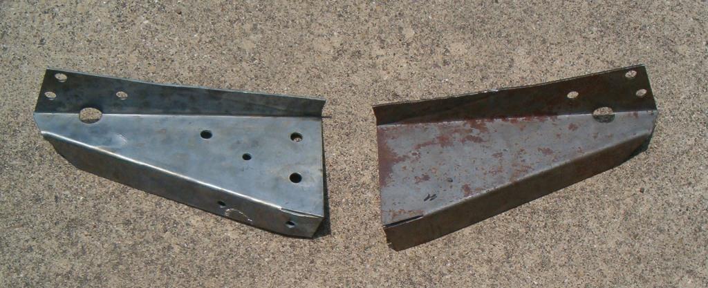

My alterations to the Brad Maurer kit...
The bottom long is how it came from Brad -
The top long is after I got done with them -

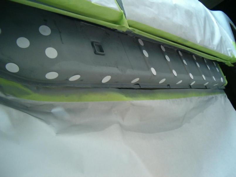

I added a signififcant number of holes for additional plug welds -
Including at the top to attach the sill plate -
I found that the zinc weld through primer did not do a very good job of letting me weld through -
so I used a the little peel and stick dots to keep primer from the areas that were to receive the plug welds... (bottom)

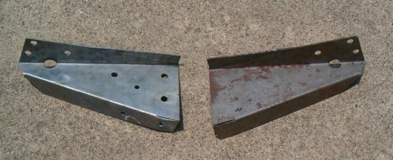

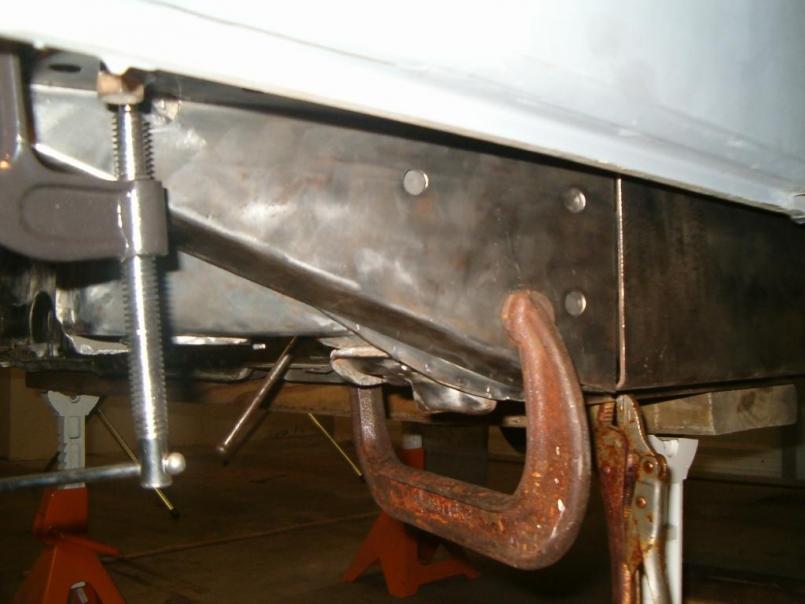

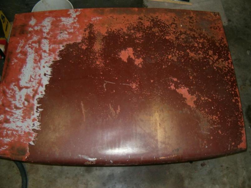

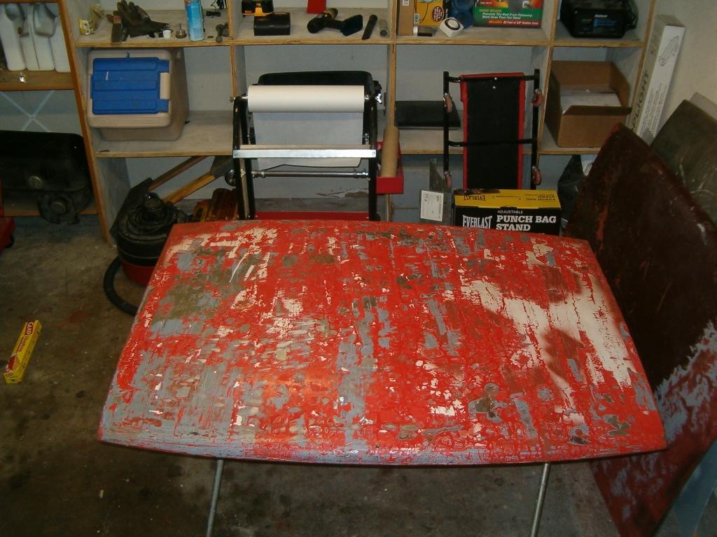

Some more pics -
Attaching the stiffining kit -

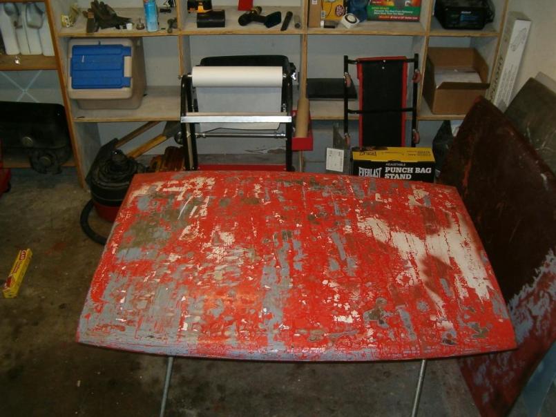

Striping hoods -
The necessary tools -
