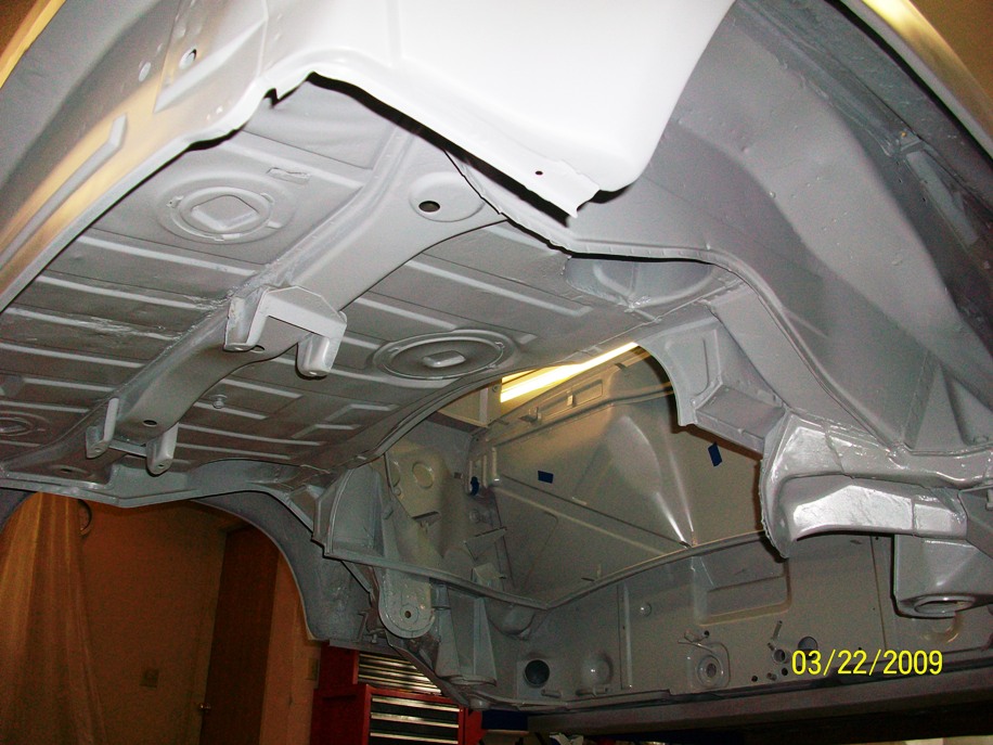

Here's some pics based on the work I have done the last few weeks...

More progress...
dakotaewing
post Apr 5 2009, 08:23 PM
Post #52
Posts: 1,167
Joined: 8-July 03
From: DeSoto, Tx
Member No.: 897
After...
