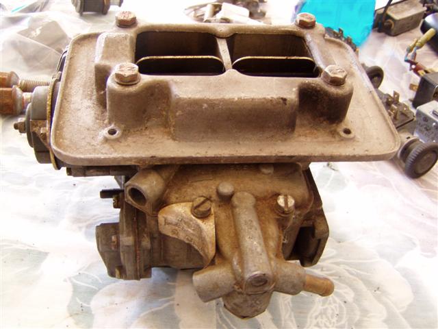

Single weber carb found in a box of parts with a parts car I had. Looked on the web, but really didn't find anything that says this carb is XYZ. So now I ask the 914 gods WTF is it.

32/34 DFT Emission Carb....should be stamped on the square base. Similar to the 32/34 DGAV....just more vacuum ports

Okay, Weber called it a 32/36 DGV, 32/36 denoting the primary and secondary bore diameters. It seems it was also available with smaller bores. Holly built them for the US manufacturers, the rest of the world got them from Weber.
It was considered a fairly high performance carb back in the day. Some guys used to run 'em with a single carb set-up on Type 1 V-dubs with some success.
