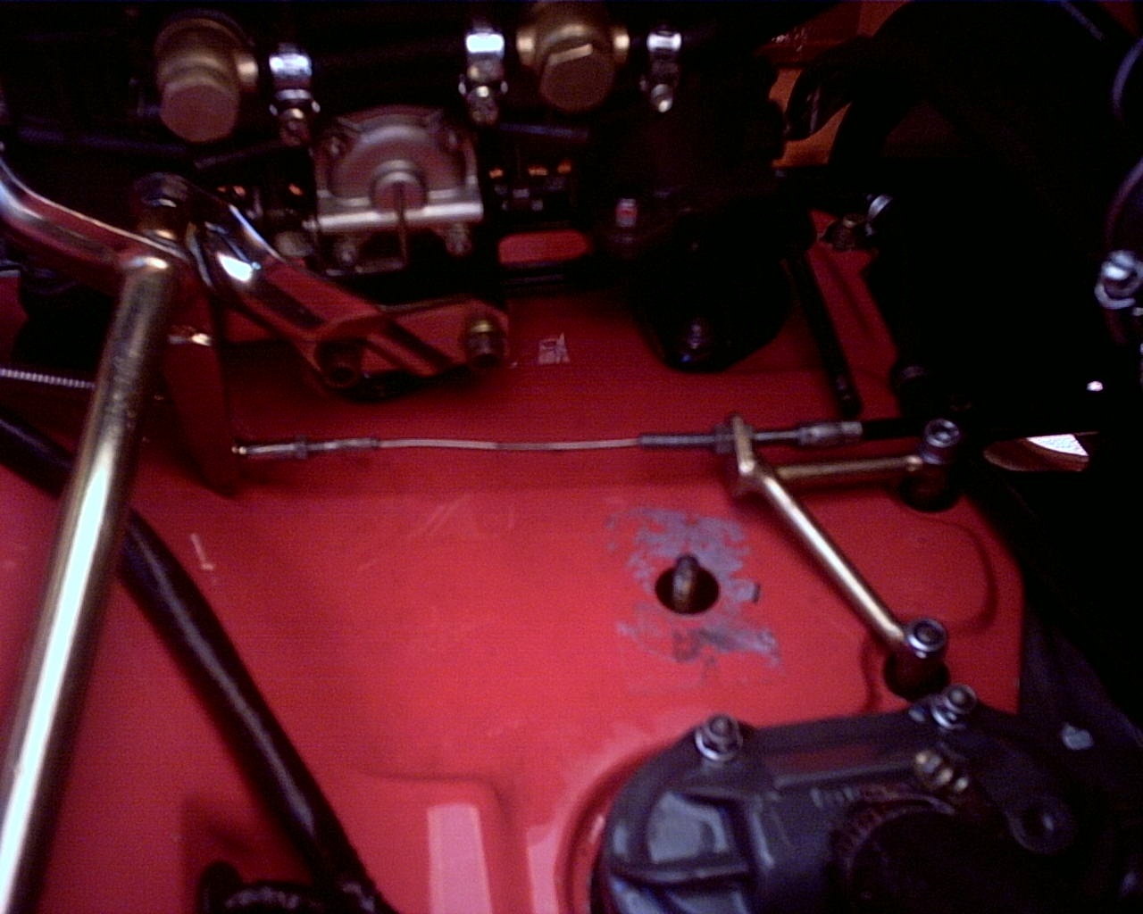

This is how I did it.

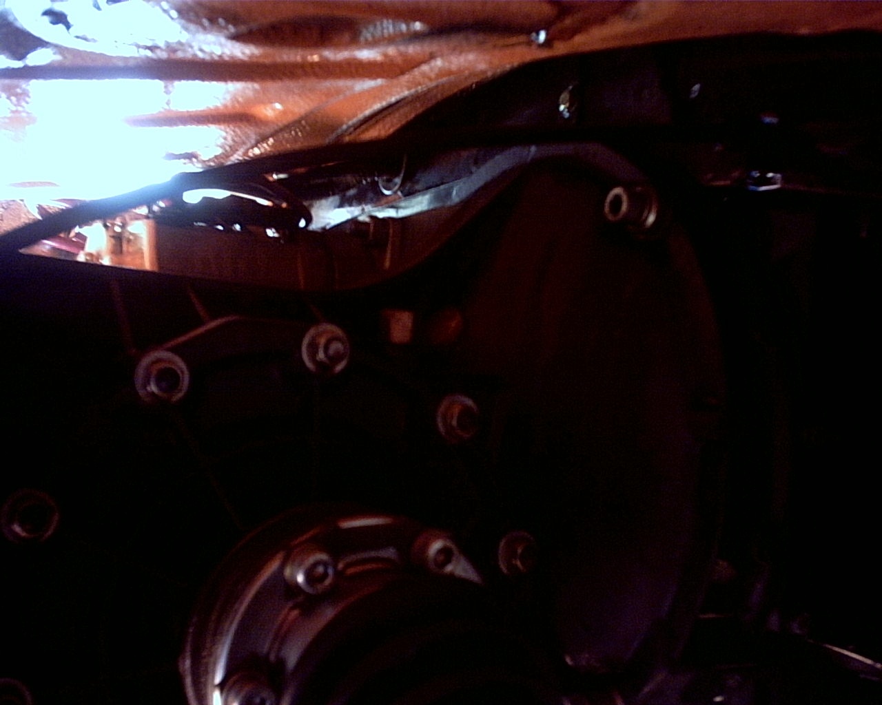

Region Association: Australia and New Zealand
More

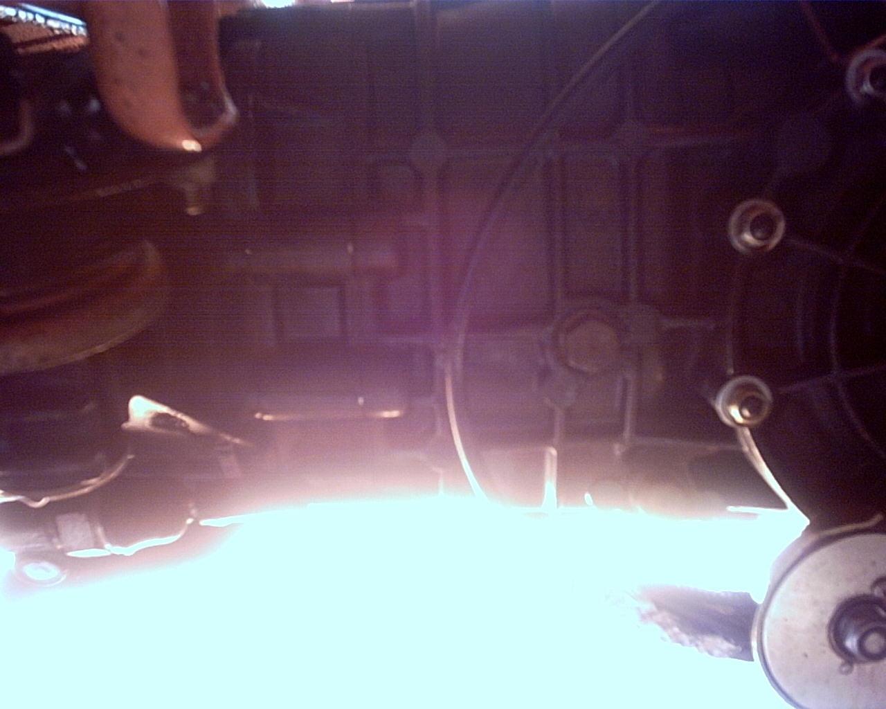

sorry there's too much daylight here!!

Maybe this will show it,
