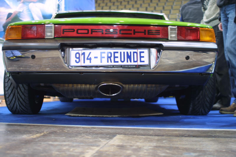

There were some pics posted in another thread of a 914 in Germany, I think, that had a Boxster muffler. I liked it! Has anyone here done that or know anything about the installation?

Here's the pic:

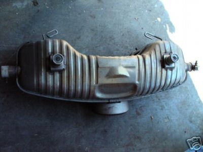

here's the muffler:

looks great ... I also like the cardboard under it to catch the drips (IMG:http://www.914world.com/bbs2/html/emoticons/wink.gif)

That muffler weighs like 60 lbs. I HATE the stock boxster muffler.

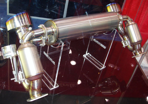

I think this might be the one MattR was referring to. It's made from titanium, and comes with a 100% guarantee. Oh, and it costs $22,500.

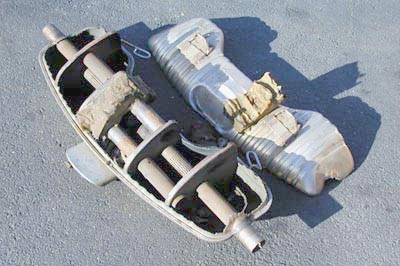

I like the cutup view picture, one could remove/modify it fairly easy I would think.....hardest part would be welding it back together and hope that the re-routed internals don't vibrate and make a racket....

That cutaway is VERY interesting! (IMG:http://www.914world.com/bbs2/html/emoticons/clap56.gif)
