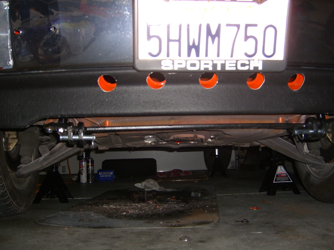

Got my tow bar bracket a couple weeks ago from David Lee.
You can find the thread in the resources section about purchasing one.
They are very sturdy and bolt right into the existing reinforced mounting area for the front of the A arms/torsion bars.
A very nice piece of equipment right from one of our very own. (IMG:http://www.914world.com/bbs2/html/emoticons/biggrin.gif)
Doesn't take very long to install.
The following are a few pics I took during intallation.

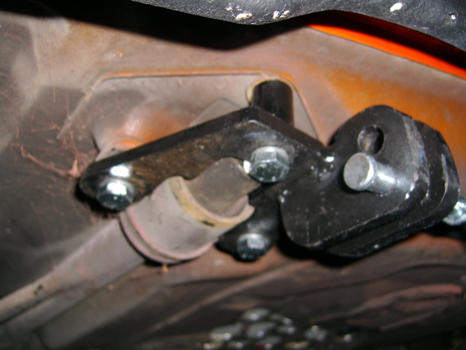

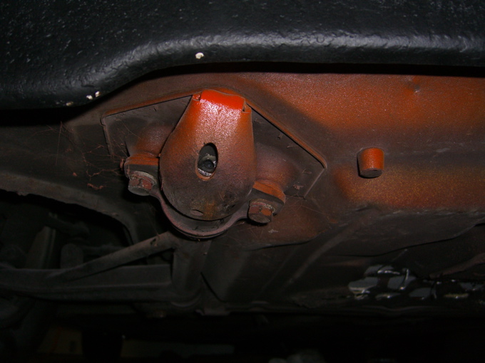

The first pic is what you see when you first look under the front of your teener and begin the install. You will see the 2 normal 17mm bolts and inside the protector cup for the front of the torsion bar tube is an 8mm allen. Up inside the little slot on the front of the cup.

Sorry about the delay couldn't get back on the site for a few minutes (IMG:http://www.914world.com/bbs2/html/emoticons/huh.gif)
Anyway, the next shot shows the cup removed and the two 17mm bolts removed. Here is what it looks like before you start the actual install.
remember that there is an 8mm allen inside the protector cup that must be removed to expose all three mounting holes

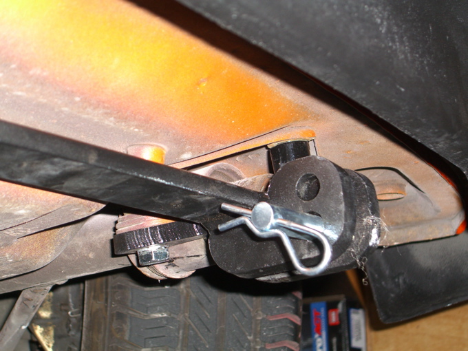

next shot shows the bar in place and hardware in for loose fit.

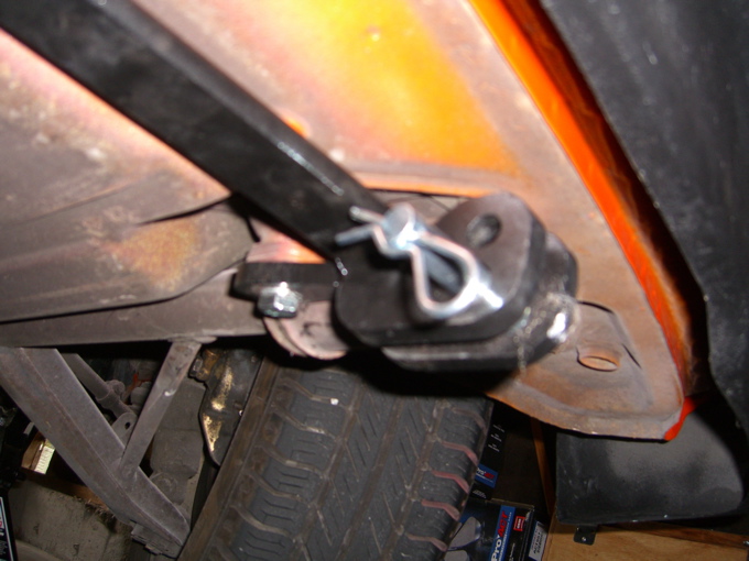

and another
As you can see from this photo, I mounted the bar under the torsion bar not above (between the chassis and the torsion bar). This would change the suspension geometry with the front of torsoin bar tube being lower than normal.
also note that the front bolt has a nicely made spacer to take up the room between the chassis and the tow bar bracket. (IMG:http://www.914world.com/bbs2/html/emoticons/biggrin.gif)

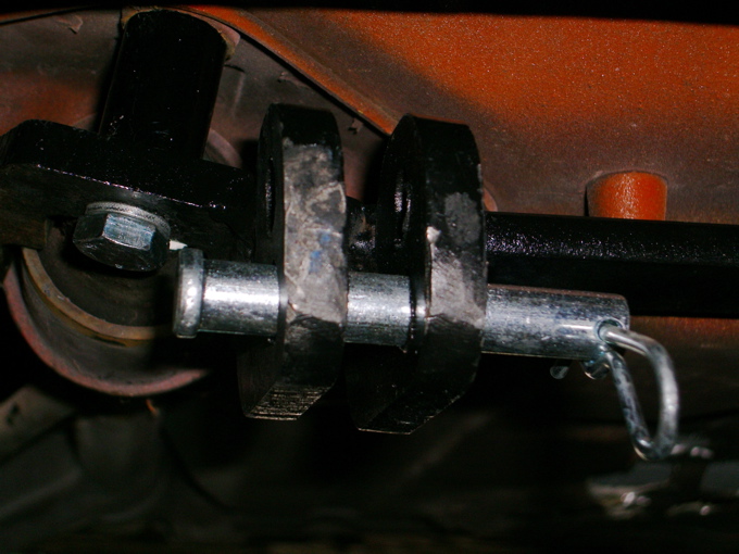

another

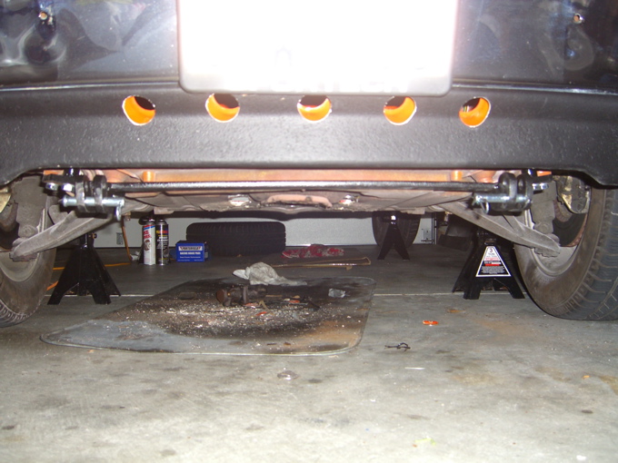

a couple of full perspective of install
