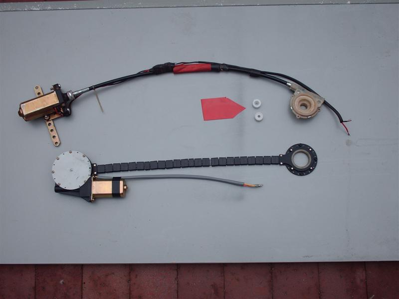

I just recieved my power window kit today and figured that I would post pics of my install/trial so you all could make up your mind if you wanted to get the inexpensive universal kits from ebay. If this install and action is successful I will have one kit available for sale with everything you need, but lets see how it works first. (IMG:http://www.914world.com/bbs2/html/emoticons/wink.gif)
(I am not at my home computer so I can not post the pics yet...I will post one of the install tonight when I get home)

Dr Evil   The handle activated would be neat. Here is a pi...   Mar 20 2006, 09:51 PM
Dr Evil   Here is one of the illuminated switches that comes...   Mar 20 2006, 09:52 PM

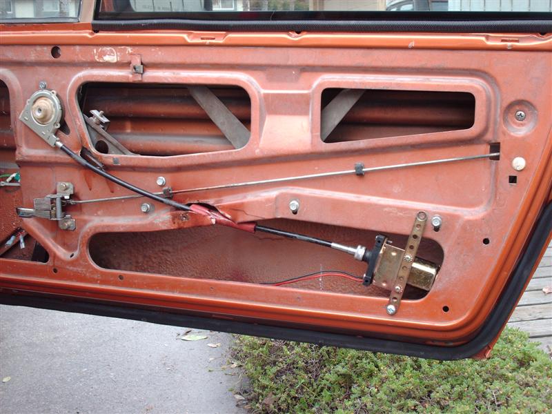

Dr Evil   Here is the unit almost all of the way installed. ...   Mar 20 2006, 09:54 PM
Dr Evil   If there is anything in particular you want to kno...   Mar 20 2006, 10:04 PM

Dr Evil   I thought that I would add some contrast in kits a...   Mar 21 2006, 11:29 AM

Dr Evil   Time for some answers: John, I was wayyy off wit...   Mar 21 2006, 03:44 PM
Dr Evil   The toothed interior piece fits over the adaptor p...   Mar 21 2006, 03:46 PM
Dr Evil   The toothed inside of the adaptor fits onto the to...   Mar 21 2006, 03:47 PM

bmunday   Mike, I assume that the toothed adapter, mounts t...   Mar 21 2006, 03:56 PM
Dr Evil   All of the kits that I have seen use this very har...   Mar 21 2006, 03:59 PM
Dr Evil   Oh, and there is more than one adaptor that will f...   Mar 21 2006, 04:00 PM
airsix   The good thing about the adaptor being made from p...   Mar 21 2006, 04:20 PM
jim_hoyland   Mike, Nice close up of the installation. Can you p...   Mar 21 2006, 10:03 PM
