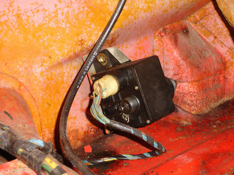

And while I'm posting pictures...and at the risk of getting (IMG:http://www.914world.com/bbs2/html/emoticons/poke.gif) ...what the heck is this thing under the passenger floorboard? Sure, I could ook it up, or trace the wires, but it's easier to ask.

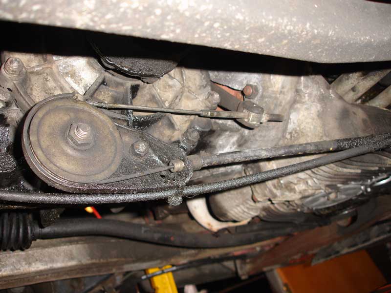

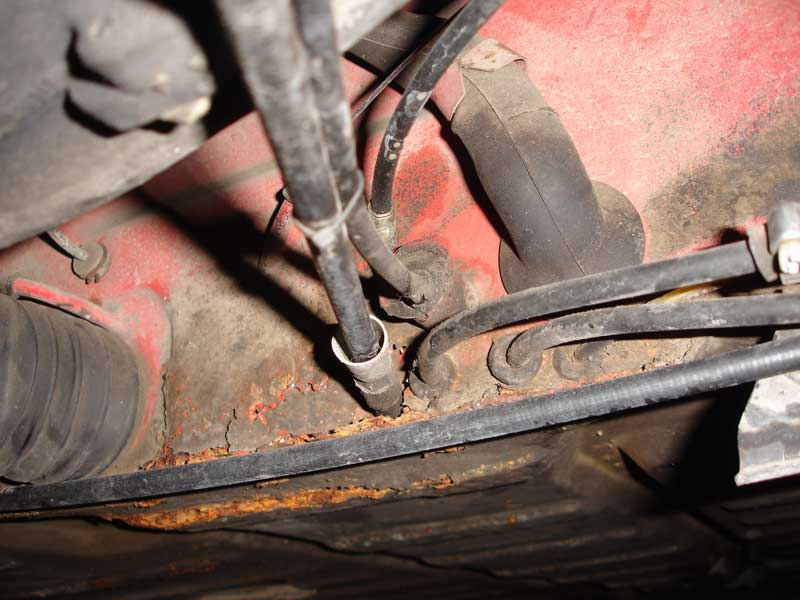

post a closeup picture from underneath the car, where the clutch cable goes into the firewall.

The box is an EGR somthing or other. Its for the emissions system.
We need pics of the cable attaching to the fork and going around the pulley, etc.
It still could be many things.

QUOTE (914-8 @ Mar 21 2006, 11:24 AM)
pic 1

QUOTE (Dr Evil @ Mar 21 2006, 11:27 AM)
pic 2

Yeah, judging by the rust, I'm going to go out on a limb and say the tube is loose.

Yep, as I suspected, the picture tells the tale.
Your clutch tube is busted. I'm not sure how it even hung in for so long with all that rust!
You've got some work ahead of you to get that cleaned up and solid again.

All of this started two days after replacing the shifter. I checked the tube while I had the shifter out, and couldn't move it at all. I poked at the firewall entry point earlier today , and it didn't wiggle at all...so I thought it might be OK. I just went back and poked again, and the whole @#%@! thing broke loose.
I guess it's time to buy a welder, and learn how to use it (IMG:http://www.914world.com/bbs2/html/emoticons/sawzall-smiley.gif) (IMG:http://www.914world.com/bbs2/html/emoticons/welder.gif) . Damn, I was hoping to put off the start of the full teardown until after the summer. (IMG:http://www.914world.com/bbs2/html/emoticons/icon8.gif) (IMG:http://www.914world.com/bbs2/html/emoticons/barf.gif)

Be careful welding the clutch tube. The gas lines run through the same area!!

The box under the floorboard is an EGR counter. It sits inline in the speedo cable and as far as I know is only responsible for turning a light on after so many thousand miles. I think it is the maintainence period for the EGR valve on emmission equipped cars or something.
