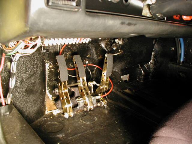

I don't have a cable - I went straight to hydraulic. It is possible to tune pedal effort a bit with that setup - but it requires using a new master each trial to do it (IMG:http://www.914world.com/bbs2/html/emoticons/mad.gif) The smaller the master, the easier it is to push the pedal, but the more pedal travel it takes to get the same displacment at the slave cylinder. I used the recommended .750" master, but I do have .700" and .625" for the brakes (.7 front .625 rear), so I am thinking that once the pedals are mounted in the car (hopefully in a couple of weeks) I want to try the setup with the .7 and .625 and see how much easier v. how much further I have to depress the pedal to get engagment.
Right now, I had a short pedal throw which is nice for racing, but very tough to modulate say around the pits - kinda like an on/off switch, so the smaller master may be nice.
Here is a shot of the Tilton triple pedal assembly I have. Now it comes painted all black which is way nicer looking - of course, that came out about 4 months after I got mine, rat bastards. You will have about a grand in this thing though after all the MCs and such and will need to cut and make a pedal box (look on this forum right now, Terrence posted a question "is the center tunnel structural" or to that effect - see what I mean).
