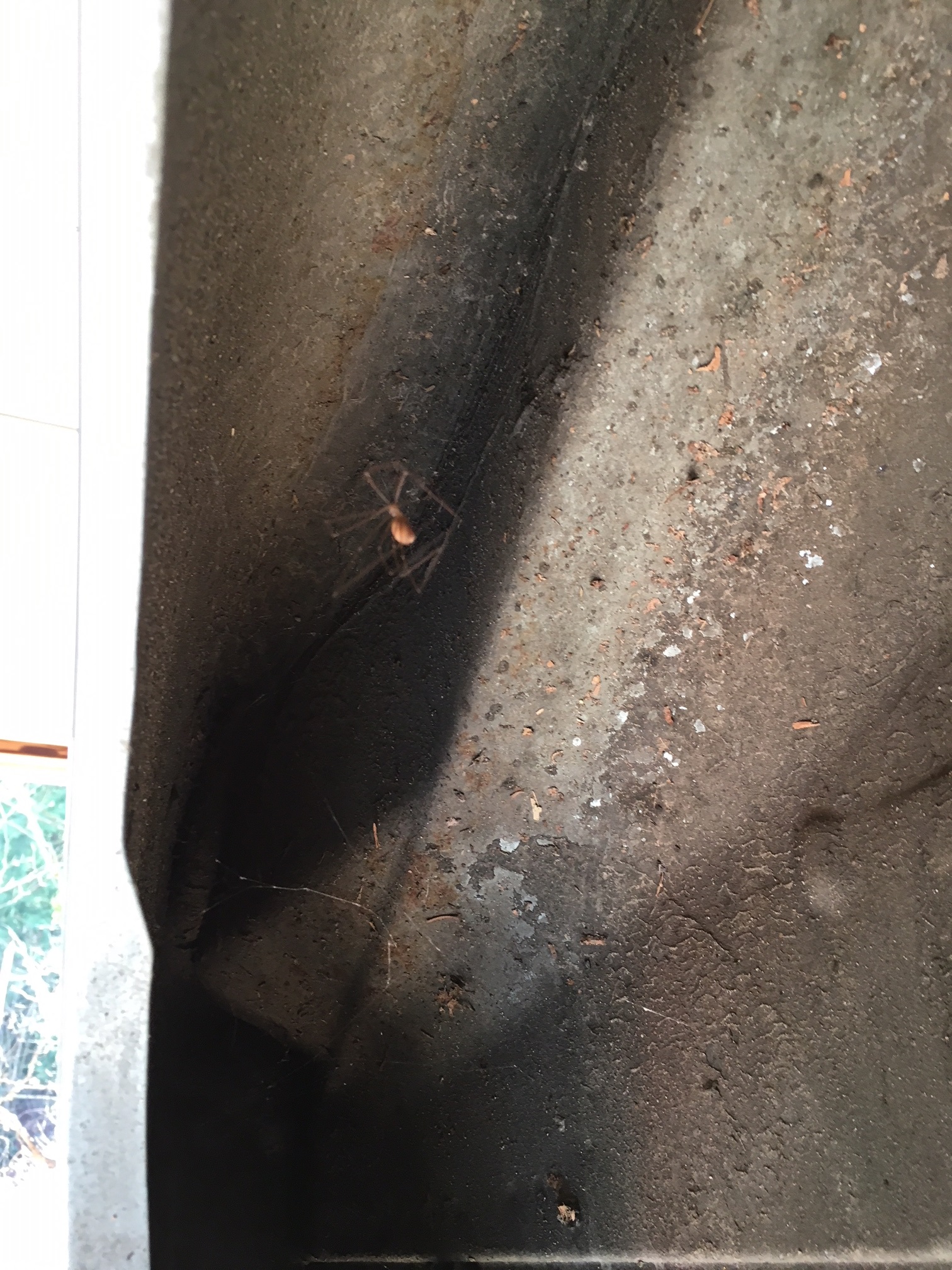

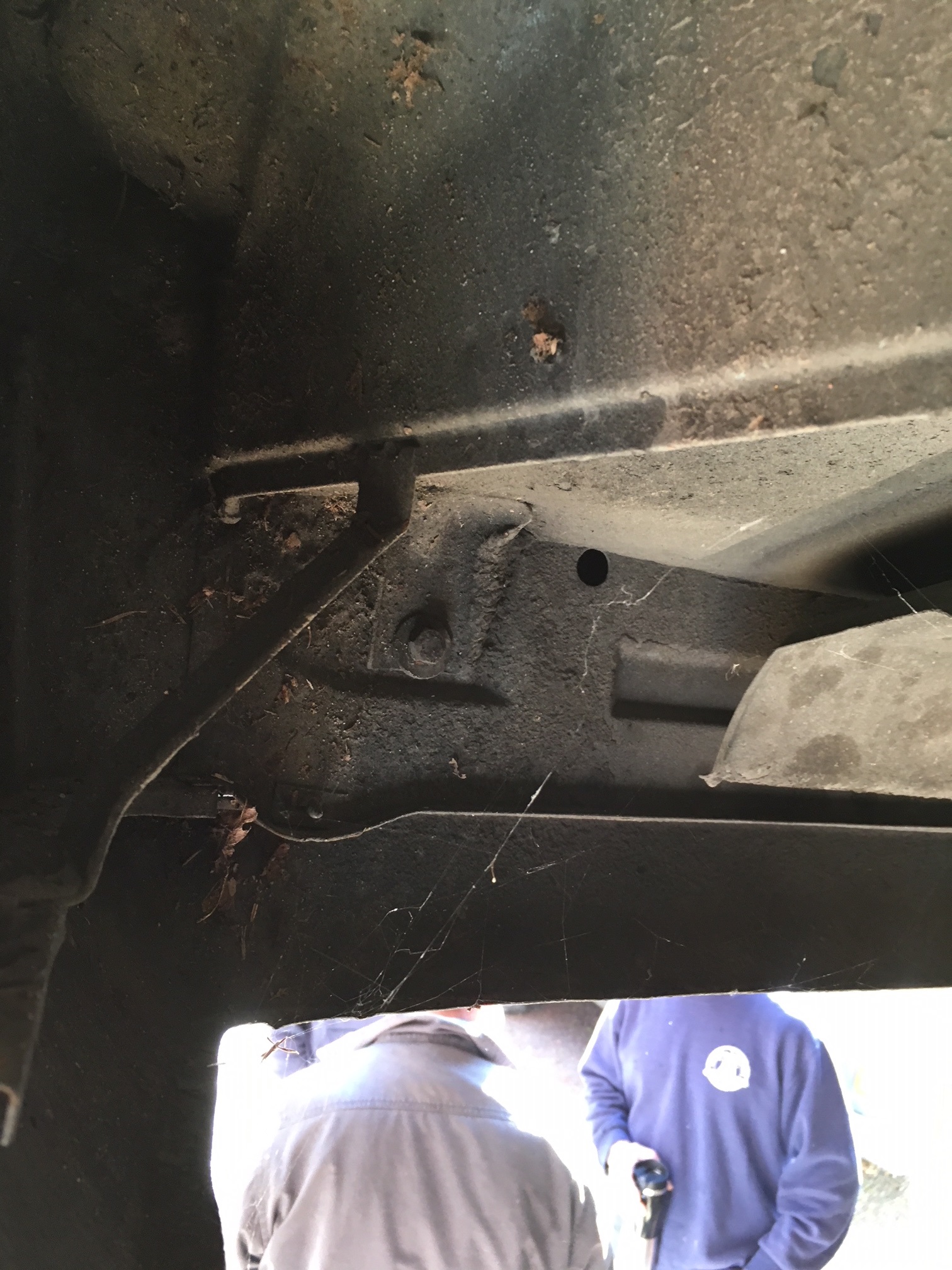

Just some photos of last Sunday's fun
What am I looking at?
And some evidence that this car needs to see some road time
And you can see that the car is serving a worthy purpose (as a spider's home!)

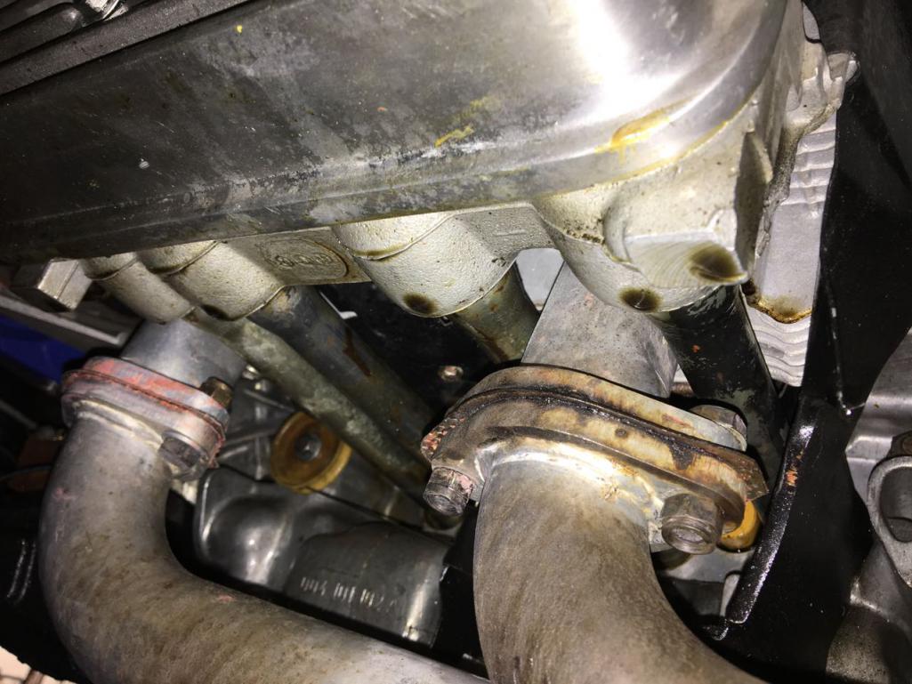

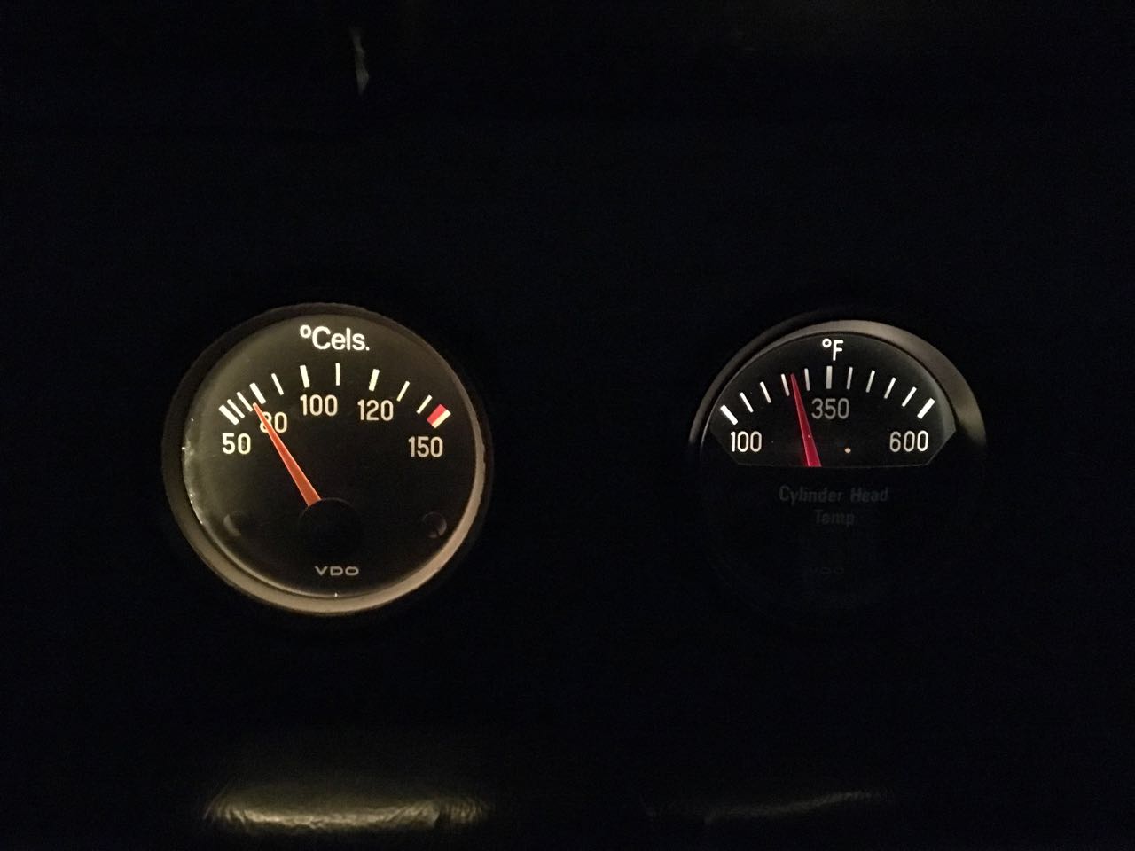

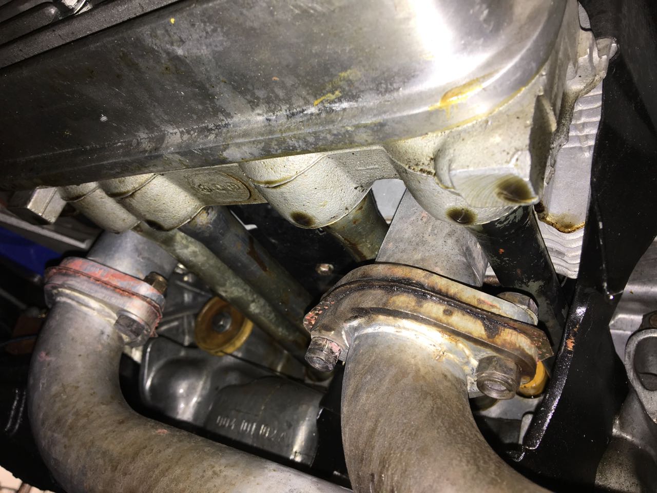

I've been assuming I need to do something about my oil leaks (and even bought a rear main seal from GoWesty) because the bottom of the car is wet and you can smell it cooking on the exhaust. But then I realized I've got 10W-30 oil in the crankcase because the previous owner in California chose this for engine break in. Searching the archives here seems to suggest a straight weight oil might be better for the Type 4. So maybe it's leaking so much just because it's such thin oil?
I'm curious what oil other people in my region are using, since the advice here might be different from SoCal. So far I don't seem to get oil temps above 80C (176F).

post Mar 21 2018, 09:26 PM
Post #5673
Posts: 134
Joined: 7-September 10
From: Puyallup, WA
Member No.: 12,150
Looks like the push rod tube seals. Very common. When you replace them ask for the better quality Viton seals which should buy you a little time before you have to replace them again.

post Mar 22 2018, 08:31 AM
Post #5674
Michael in Seattle
Posts: 373
Joined: 7-October 17
From: Seattle, WA
Member No.: 21,495
QUOTE(Mr. Olympic Blue 2 You @ Mar 21 2018, 08:26 PM) *
Yes, I'm pretty sure that's one source of the leaks. I'm wondering whether it's actually kind of expected given the thin break-in oil I've got, which is why I'm asking what other people in this region are running.

I'm running Valvoline VR-1 Racing 20w-50w in my '74 CanAm LE with a stock FI 2.0 motor. It's around the highest zinc content oil commonly found at an auto parts store.
The other '74 914 with an '87 3.2L Carrera motor gets by on Swepco 306, also 20w-50w.
We live in a mild climate so we don't get the temperature extremes some areas have. Both cars started easily in our last freezing.

post Mar 23 2018, 09:56 PM
Post #5676
Posts: 544
Joined: 9-November 03
From: Southeast of Seattle
Member No.: 1,323
Unfortunately I don't think that much oil is from using a thinner viscosity. I agree with Mr. Olympic's assessment: you need to replace those push rod tube seals ASAP. Its a shame that a fresh build motor is leaking already, but the good news is that you can replace them before you end up with years of grime under the car. What's there should clean up pretty easily.

(IMG:style_emoticons/default/agree.gif) Fairly easy job to do at least.
