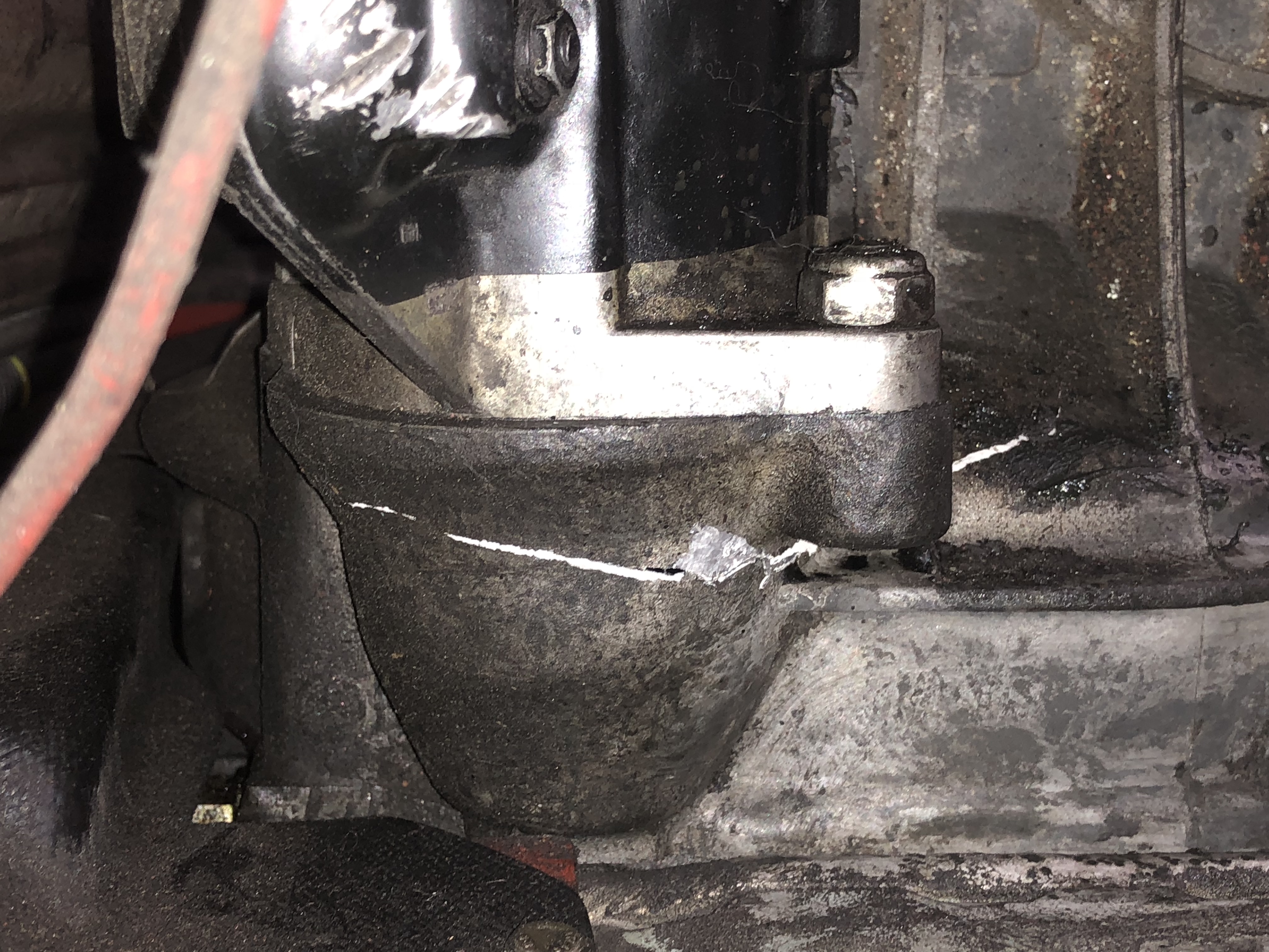

Well this sucks...accidentally released the clutch while in first gear at a stop light the other day and it cracked my transmission. So I’m wondering if anyone local has one they are willing to sell. (IMG:style_emoticons/default/headbang.gif)

James what or where did it "crack"
jcambo7
post Aug 2 2018, 05:28 PM
Post #5771
Posts: 1,703
Joined: 24-December 08
From: Graham, WA
Member No.: 9,867
At the starter mount. Sorry the image is sideways. Posting from my phone.

Ouch!
You should post a warning before putting up a picture like that! (IMG:style_emoticons/default/biggrin.gif)

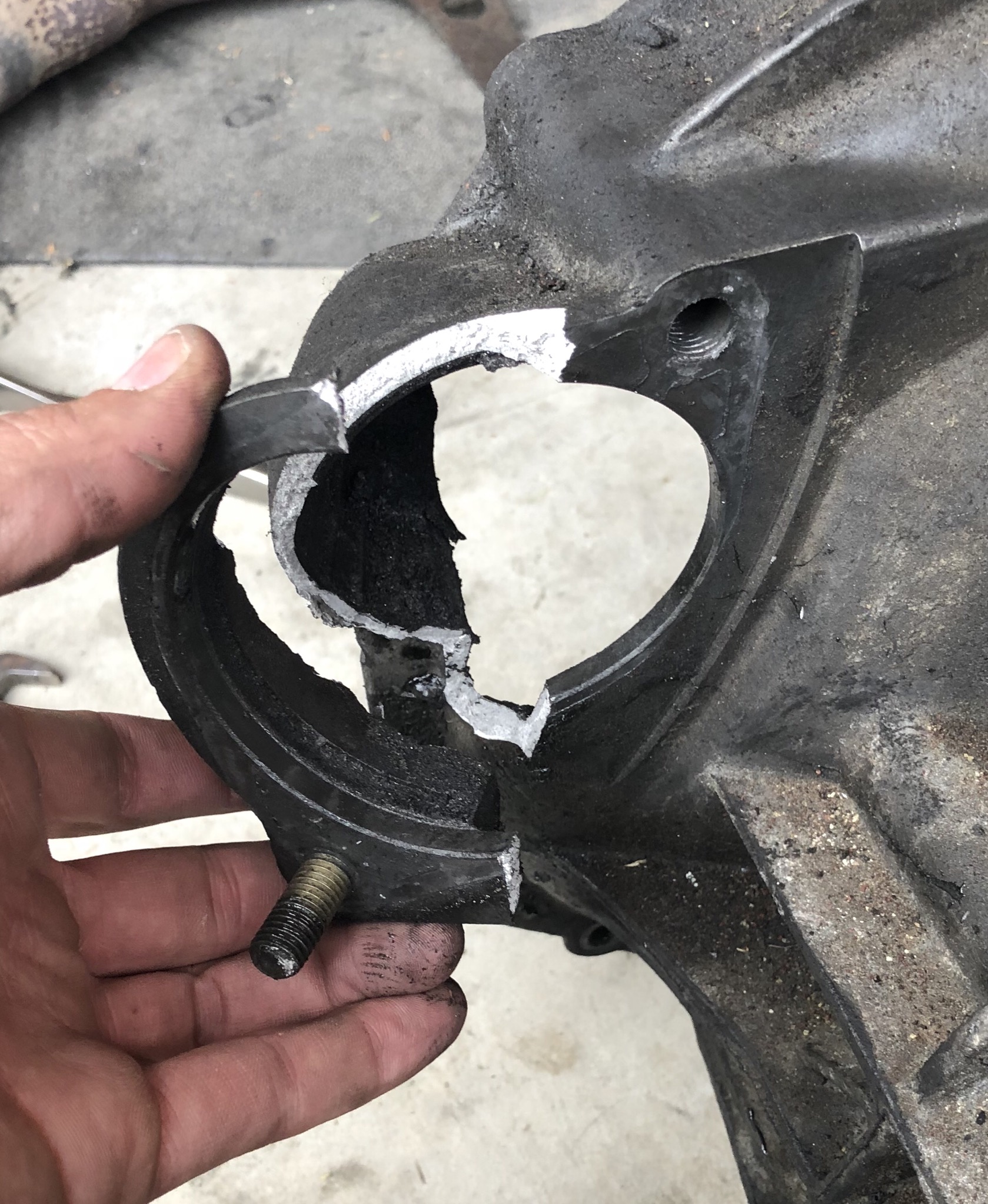

Thats real odd! Best to pull the trans & inspect.
Does the Starter solenoid still engage the flywheel?
Id take Todd up on his offer otherwise I have one as well.

It still starts up. When it happen it sheared off two of the axle bolts on the transmission side and the other two I believe were completely loose since they didn’t shear. I was able to start it in neutral after I looked under the car right after I heard the loud bang

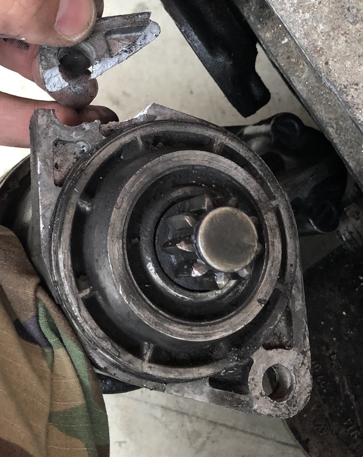

Just pulled the transmission off. Discovered the upper mounting hole for the starter broke also. So I need a new starter. Anybody got one I can buy?

I think the fact that two of the axle bolts on the left axle were not tight at all, aided in it. The torque sheared the other two axle bolts and possibly threw the axle up into the starter with so much force it caused the case to crack around it. The right axle bolts were all the way tight.
