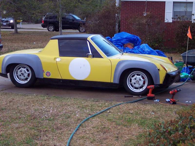

Rivets Baby
BIG SEXY RIVETS.

(IMG:http://www.914world.com/bbs2/html/emoticons/agree.gif) with Joe. Sooner or later the fiberglass will crack, so unless you do it up right (steel) just rivet the 'vette parts on.

Nah, I'm not worried about that. I am fairly sure I will end up ripping off or smashing a flare. Easier to get off and slap another one on when riveted.
Shhhh and it makes it look like a race car. (IMG:http://www.914world.com/bbs2/html/emoticons/biggrin.gif)

Use a rivet for that hard core look. You can put some molding around the edge of the glass fender and make it look pretty good. The other ways take way to much time and the results can be sketchy. The next set I do will be rivited on.
