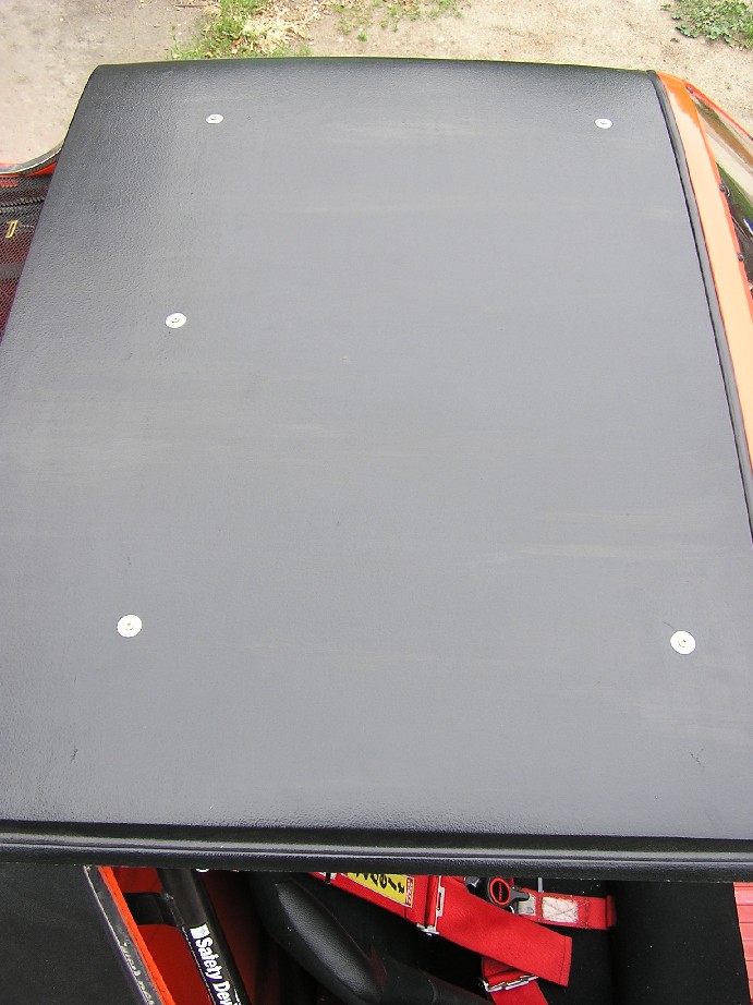

#5
I built the lightest 914 in the history of mankind. ![]() ![]() ![]() ![]() ![]() ![]() ![]() ![]() ![]() ![]() ![]() ![]() ![]() ![]() ![]() ![]() ![]() ![]() ![]() ![]() ![]() ![]() ![]() ![]() ![]() ![]() ![]() ![]() ![]() ![]() ![]() ![]() ![]() ![]() ![]() ![]() ![]() ![]() ![]() ![]() ![]() ![]() ![]() ![]() ![]() ![]() ![]() ![]() ![]() ![]() ![]() ![]() ![]() ![]() ![]() ![]() ![]() ![]() ![]() ![]() ![]() ![]() ![]() ![]() ![]() ![]() ![]() ![]() ![]() ![]() ![]() ![]() ![]() ![]() ![]() ![]() ![]() ![]() ![]() ![]() ![]() ![]() ![]() ![]() ![]() ![]() ![]() ![]() ![]() ![]() ![]() ![]() ![]() ![]() ![]() ![]() ![]() ![]() ![]() ![]() Group: Members Posts: 127,805 Joined: 3-February 03 From: Jacksonville, FL Member No.: 222 Region Association: None ![]() |
No not yet, my schedule has need screwed up. Maybe in a few weeks. Here is a pic... BTW, I use the Moroso brand, most speed shops have them. Attached image(s) ![]() |

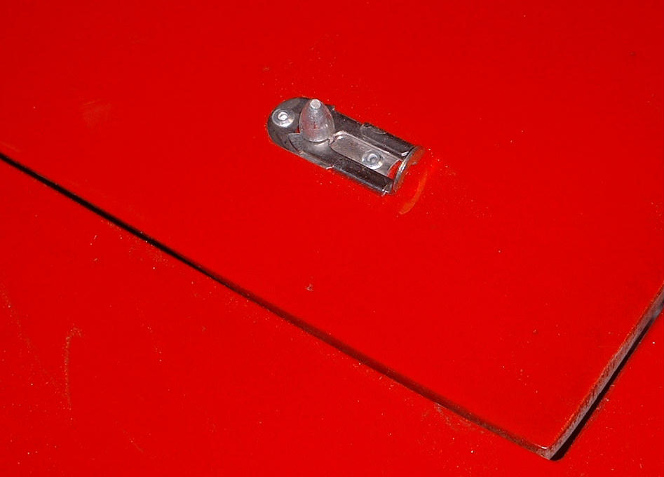

#16
I use two of these on the rear of my hood.
(boy that paint sure is red) (IMG:http://www.914world.com/bbs2/html/emoticons/wink.gif) Attached thumbnail(s) ![]() |
