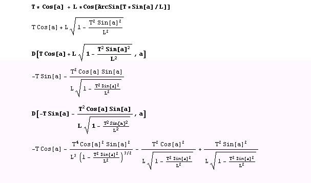

I keep reading this but it's not intuitively obvious to me that piston speed decreases as the length of the connecting rod increases so I tried to do the math. The equation I get for the position of the connecting rod small end as a function of the angle of rotation of the crank, a, the crankshaft throw, T, and the connecting rod length L is:
x = T* Cos[a] + L*Cos[ArcSin[T*Sin[a]/L]]
then dx/da and d^2x/da would be

meaning there is a rod length dependance on piston 'velocity' (if velocity is defined wrt to time constant rotation).
i had trouble with the dimensional analysis - shouldn't the units be mm squared per degree?

I could be wrong, but I believe the main issue is the stress generated by an excessively short rod, largely due to the added acceleration (speed) generated by being more closely connected to the crank. As the crank passes 90 degrees from TDC, the short rod has a greater moment of acceleration based the steep angle it has in relation to the wrist pin and crank journal. A longer rod would have a less severe angle and have more even acceleration and less stress. I’m not a math guy… so I can’t back this up with any figures, but it seems to make sense…. At least in my own little world.
