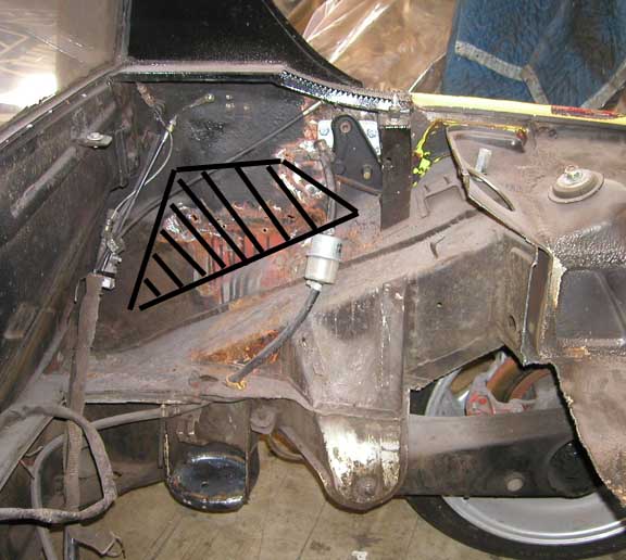

The 2000 Audi S4 drivetrain fits with no major interference issues except where the stock intercoolers mount on either side of the engine. In the 914 this is the location where the "shelf" is located. I was wondering if I can cut the sidewall to the inside of the flare where I planned to mount these intercoolers. Would this significantly weaken that area? I actually would like to cut more than hatched area...

maybe use a strong webbing/net to weld in the opening? ads some strenght where you removed it...

Have you thought about mounting them where you have the room...and make some new IC piping to accomodate the change in position. You can still use the stock Y pipe for a stock 2.7T looking appearance.

As far as the intercoolers go, I think your idea of mounting them in the fenders should work with some reinforcing.

"The question is, will this be sufficient? Should I resize them or find another location (I do want my trunk space)? If need be, I will convert from water to air IC to make it more efficient. It's GOOD to have water cooling available (Eric). (IMG:style_emoticons/default/biggrin.gif) In that case it may be easier to relocate."
All of the discussions on the board about locating oil coolers and AC condensers in the engine compartment or rear fender wells all conclude with the fact that its difficult to get adequate airflow in these areas. If there is a lot of heat to reject these spaces have real limitations. As a casual observer, I would think you would be better off keeping the water cooled intercoolers and rejecting the heat through your radiator, which I assume will be front mounted. Concentrate on the front radiator mounting and its airflow. After all, that's what Audi did. (IMG:style_emoticons/default/idea.gif)

I was incorrect to say "from" water to air IC, it is currently air to air. Water cooling will complicate the plumbing and I haven't even dealt with the heater yet. Considering the engine heat and yes the turbos will multipy that, if I cut the sidewall it will primarily be for a little extra space for the intercoolers. And I thought the "bigass flares" would be big enough for the ~7" wide IC's! (IMG:style_emoticons/default/laugh.gif) I can put another cover on it to insulate them from the heat which will re-strengthen that wall.
I'm going to try stock location first and as Sonu suggests the plumbing can be re-routed. If I relocate them too far from the engine, the air will have to travel even further. Maybe supplemental inline cooling would work (IMG:style_emoticons/default/idea.gif)
