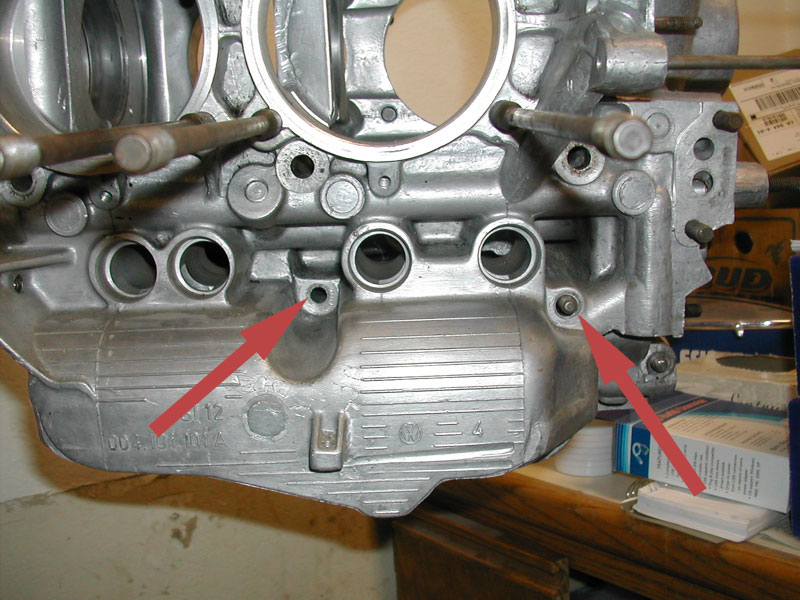

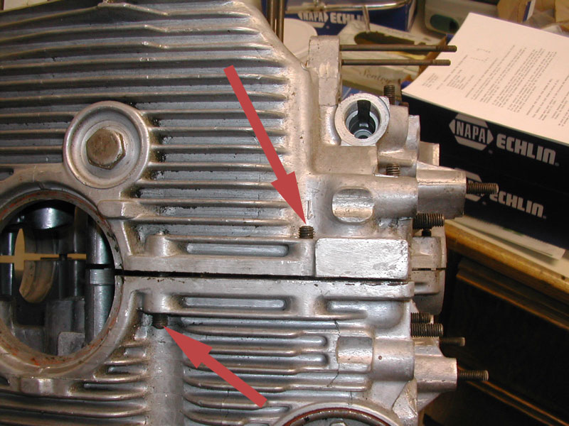

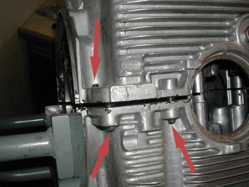

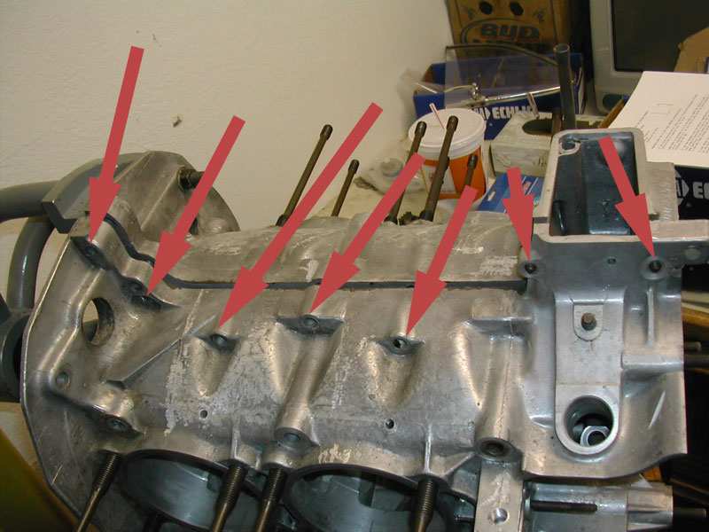

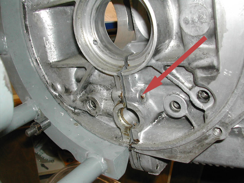

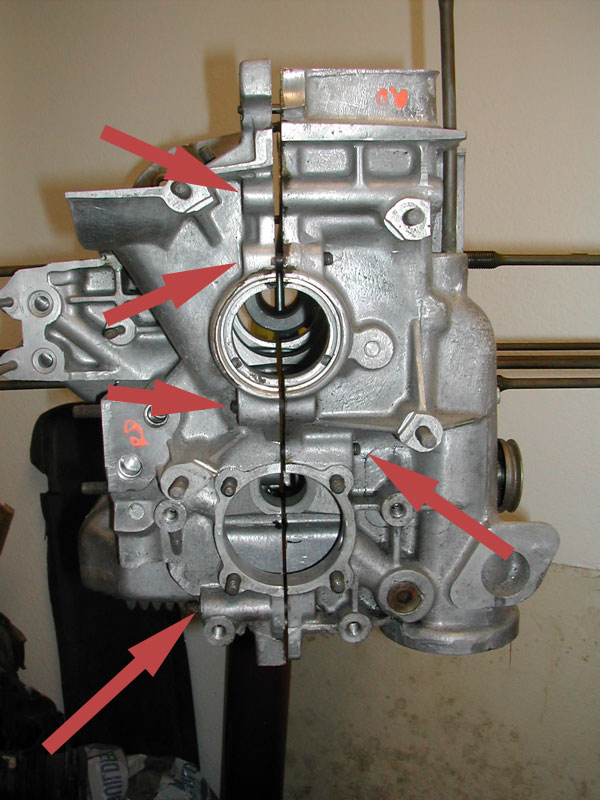

Here are all the case perimeter bolts. I only put an arrow to each bolt ONCE, even though the same bolt can appear in multiple pictures. There are 20 bolts holding the case halves together, not counting the big BIG through bolts.
Front Bottom (IMG:http://www.914world.com/bbs2/uploads/post-419-1146160850.jpg) Front (IMG:http://www.914world.com/bbs2/uploads/post-419-1146160820.jpg) Top (IMG:http://www.914world.com/bbs2/uploads/post-419-1146160838.jpg) Rear Bottom (IMG:http://www.914world.com/bbs2/uploads/post-419-1146160869.jpg) Rear (IMG:http://www.914world.com/bbs2/uploads/post-419-1146160882.jpg) Side (IMG:http://www.914world.com/bbs2/uploads/post-419-1146160896.jpg) |
