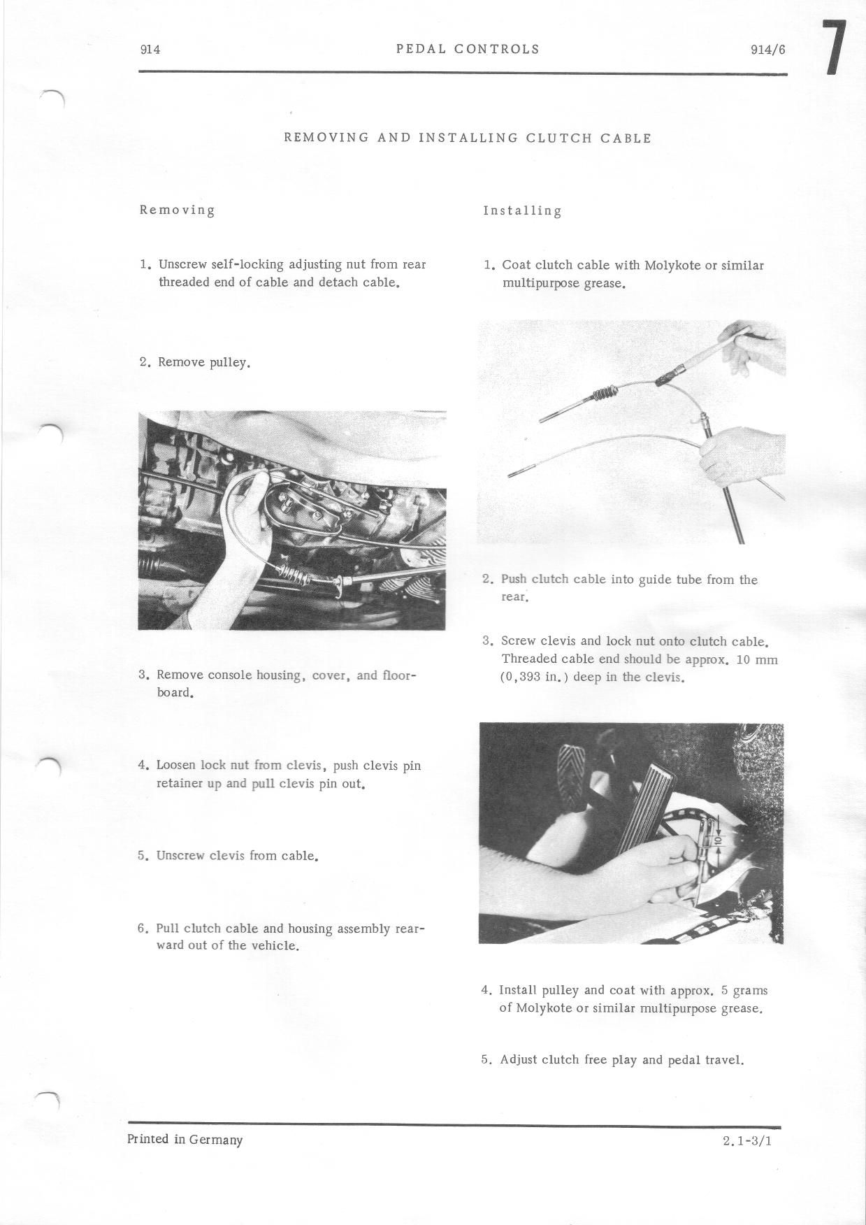

I have emailed Terry cables, no response yet, but I did locate this from the factory manual:

QUOTE(Jeff Bowlsby @ May 1 2006, 12:34 PM) *
yeah, but did you notice how clean that 914 looks? i doubt it had ever seen any dust at the time those pictures were taken ...

The factory cable isn't teflon coated. (IMG:style_emoticons/default/wink.gif)
